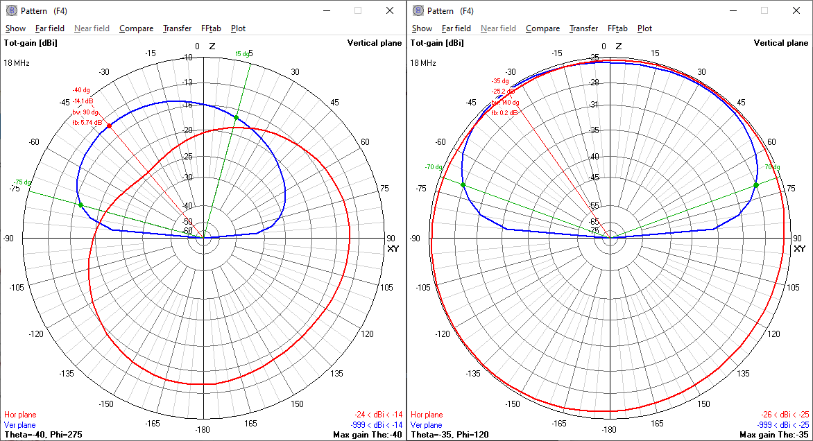

Just a note, the LoG with a perimeter of (about) 18m will mantain its pattern up to about 10MHz, willing to go further up in frequency you'll need to reduce the loop size, the image below shows the patterns at 18MHz for two LoG antennas
- log18.png (102.93 KiB) Viewed 93925 times
to the left you can see the pattern of the 18m LoG, to the right the one of a 3m one, as you see, by reducing the loop size the pattern is restored, the price to pay is the gain which, by the way, gets lower and that's also why Matt (KK5JY) recommends the use of the LoG for frequencies below the 30 meters band, since, while it's possible to reduce the size of the LoG to go up in frequency, the resulting antenna won't offer the same performance as the larger one at lower frequencies

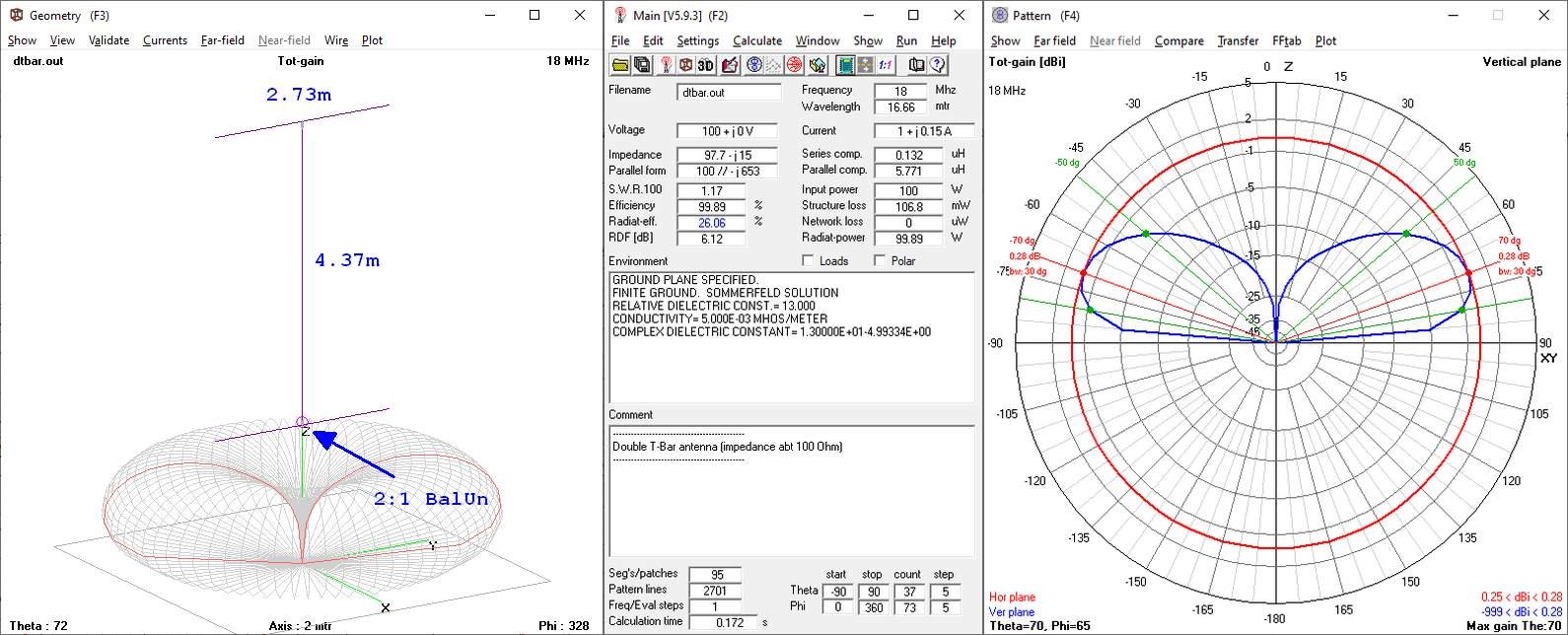

If you want a low angle antenna for 18MHz, here's one which may fit and which will work really well near salt water, the model is set for aluminium pipes, but it can be easily modified to copper wires (in such a case you'll need some non conductive support structure)
CM --------------------------------------------
CM Double T-Bar antenna (impedance abt 100 Ohm)
SY freq=18.000 ' calc frequency
SY test=18.000 ' test frequency
SY vrad=0.015 ' vert section radius
SY hrad=0.010 ' horz section radius
SY cfac=0.965 ' length correction factor
SY wlen=(300/freq) ' lambda
SY wave=(wlen*cfac) ' correction factor
SY hght=2 ' height from ground
SY hats=(wave*0.085) ' capacitive hats arms length
SY vert=(wave*0.272) ' vertical section length
SY toph=(hght+vert) ' height of antenna top hat
SY segl=51 ' segments for long sections
SY segs=11 ' segments for short sections
SY fseg=1 ' feeding segment
' vertical section
GW 1 segl 0 0 hght 0 0 toph vrad
' top hat
GW 2 segs 0 -hats toph 0 0 toph hrad
GW 3 segs 0 hats toph 0 0 toph hrad
' bottom hat
GW 4 segs 0 -hats hght 0 0 hght hrad
GW 5 segs 0 hats hght 0 0 hght hrad
' ground
GE -1
GN 2 0 0 0 13 0.005
' loading (58000000=copper, 37700000=aluminium)
LD 5 0 0 0 37700000
' feeding
EX 0 1 fseg 0 1. 0 0
FR 0 0 0 0 test 0
' end
the resulting antenna will show the following characteristics
- dtbar18.jpg (207.09 KiB) Viewed 93925 times
as you see it offers omnidirectional pattern and very low launch angle w/o the need to be placed high (the antenna in the model is installed with the bottom at 2m from ground)
