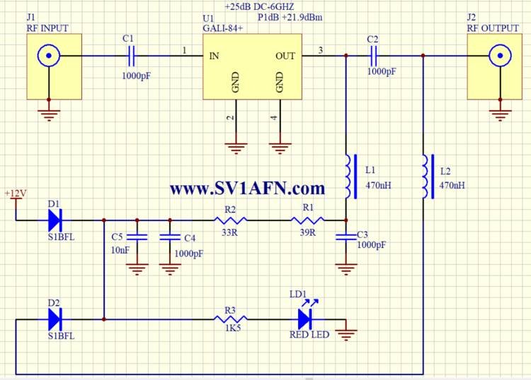

This is strange, see, the GALI-84+ declares an operating range (and gain) from DC to 6 GHz, and the SV1AFN web site says that that preamp works
from LF up to 4GHz; did you try mailing SV1AFN and asking some clarification ? as for the 12V, the
GALI datasheet states that the IC operating voltage is around 6V, but if you then look at the
SV1AFN schematic
- 29-11-2019-16-25-5de1468186347.jpg (83.78 KiB) Viewed 139009 times
we can clearly see that the preamp wants 12V, this is probably due to R1/R2 which are dropping the voltage (the power comes from the Bias-T formed by C2/L2); also, looking at the circuit, the frequency range limit is most probably set by C1/C2 and L1/L2, but then given that SV1AFN states that the unit works from LF, the fact that it has very little gain down on MW seems strange
