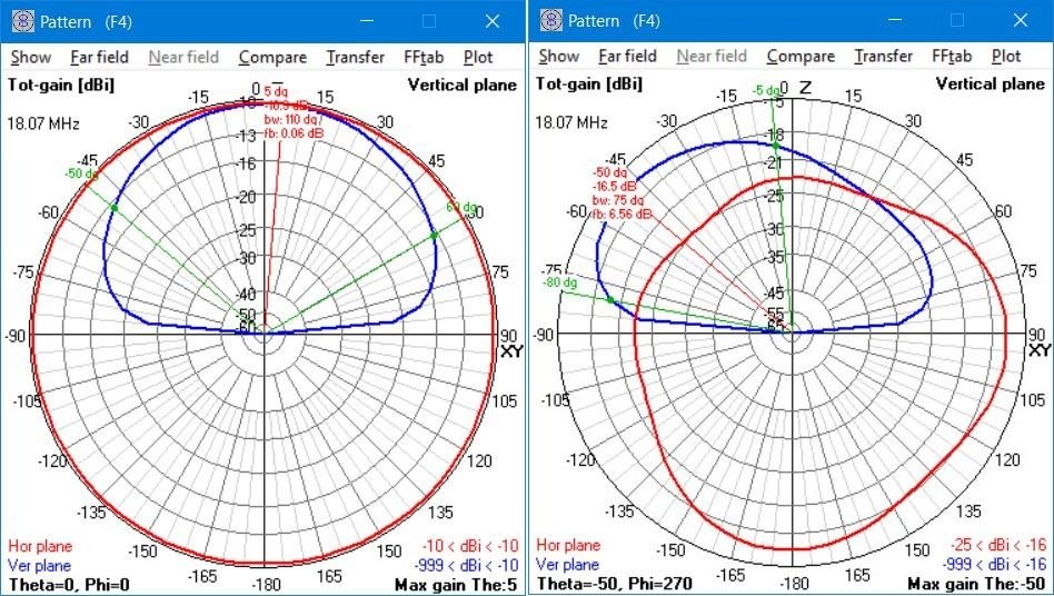

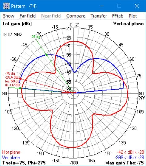

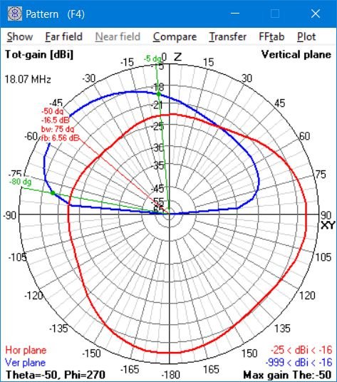

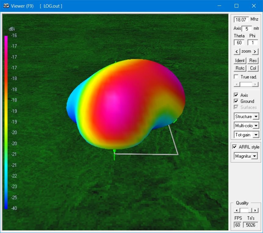

Thanks for the .nec file! That gave me an opportunity to finally install 4NEC2 and be utterly confused by it! :)
I changed the geometry to reflect my plain 20m circumference loop and I was particularly curious on A) the influence of ground conductivity / dielectric constant on gain and B) elevation angle at C) higher bands like 14 and 18 MHz. I compared "sea water" with "polar cap" (worst case) and the simulation seems to say...
- Unexpected by me, the "better" the ground is, the lossier the LoG will be? At the North Pole, it will have very little losses and even a little bit of dBi gain beaming straight upwards, but it will lose some 30dB over the ocean?
- It seems to confirm my evidence-supported theory that the better the ground, the flatter the lobes will be. This is because the LoG is by all means a vertically polarized antenna of course, even though it boggles the mind when you look at a LoG and fail to even see it in the high grass. :)
The LoG on polar permafrost (18 MHz):
On Saltwater (18 MHz):
Interesting cloverleaf pattern! Now my LoG is not really over saltwater at the dike, it's just very close (50m) to it and I guessed that "very wet ground" (which proves true after only little rain when I can't park my car on the meadow close to the dike because the tires may sink into the ground) would be a serviceable approximation to the conditions there. This has some odd effect on the horizontal pattern in the simulation for 18068 kHz:
Looks like it becomes almost unidirectional! Now I know that this will change with a lot of parameters and conditions and can't be generalized or even predicted much, it will look very different on 14 or 21 MHz in the simulation (but very similar on 28 Mhz!) but still, maybe it's worth anticipating this when deciding where to put the feedpoint of the LoG?
That sure would make it worthwhile to have an easy way to shift the feedpoint around!

Re: LoG antenna trick
Andrew (grayhat) wrote: Tue Jun 14, 2022 3:29 pm Ollie, a bit of warning here; NEC modeling may be addictive and you may start modeling an antenna and adding to the model wireframe models for buildings, trees and so on :lol:
I couldn't stop playing with it all afternoon, good point! :) OTOH, I understand very little of it, likely not enough to use it in any meaningful way, not to mention modeling the environment. However it obviously proved already useful with your help!
Even though I either dropped the LoG or put up the 10m vertical monopole at the dike and never compared them directly yet, it always puzzled me how similar the LoG performed to the vertical, using crazy weak VOLMET signals from AUS and ZL I recorded with both of them (at different days of course) as an indicator. With both antennas 14 and 18 MHz never "close" at night unless there's some bad radio blackout conditions, typical telltale effects of flat elevation angles. When testing horizontal wires and SMLs at the dike the opposite effect can be observed - the steep angle signals drop off with the MUF decreasing after sunset but the flat angle signals don't really kick in - > dead high bands.

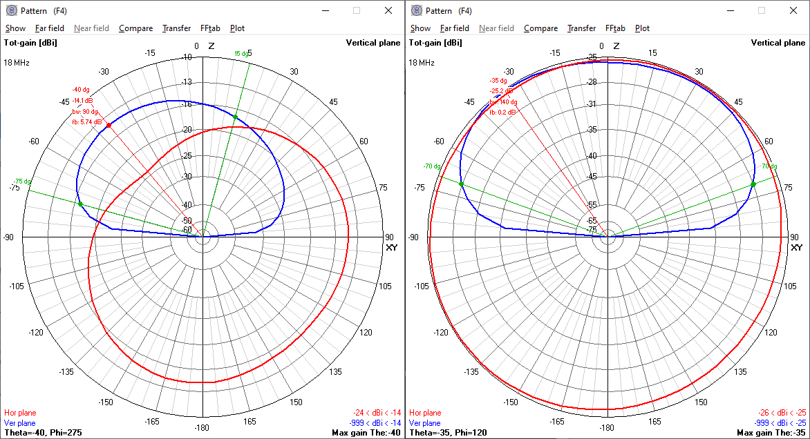

BTW, here's a nice demonstration how this works both ways:
Edit: OMG, there is so much to learn from this! :) IIRC some post(s) in some discussion somewhere suggested that minimally elevating the wire would be advantageous. According to the simulation, only a few centimeters dramatically decrease the influence of the ground and turn the LoG into a "cloud warmer". It also decreases the losses so I think I get how this could be perceived as beneficial, stations coming in from high angles are a little louder.
Left: 5cm high wire. RIght: (wire*3.3)

13dka wrote: Tue Jun 14, 2022 9:28 pm Edit: OMG, there is so much to learn from this! :) IIRC some post(s) in some discussion somewhere suggested that minimally elevating the wire would be advantageous. According to the simulation, only a few centimeters dramatically decrease the influence of the ground and turn the LoG into a "cloud warmer". It also decreases the losses so I think I get how this could be perceived as beneficial, stations coming in from high angles are a little louder.
Just a note, the LoG with a perimeter of (about) 18m will mantain its pattern up to about 10MHz, willing to go further up in frequency you'll need to reduce the loop size, the image below shows the patterns at 18MHz for two LoG antennas
to the left you can see the pattern of the 18m LoG, to the right the one of a 3m one, as you see, by reducing the loop size the pattern is restored, the price to pay is the gain which, by the way, gets lower and that's also why Matt (KK5JY) recommends the use of the LoG for frequencies below the 30 meters band, since, while it's possible to reduce the size of the LoG to go up in frequency, the resulting antenna won't offer the same performance as the larger one at lower frequencies

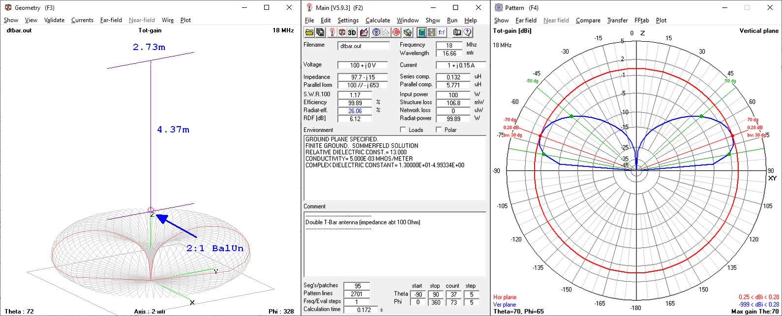

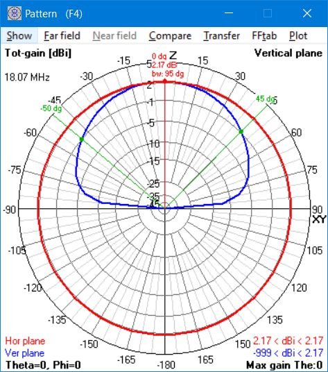

If you want a low angle antenna for 18MHz, here's one which may fit and which will work really well near salt water, the model is set for aluminium pipes, but it can be easily modified to copper wires (in such a case you'll need some non conductive support structure)
CM --------------------------------------------
CM Double T-Bar antenna (impedance abt 100 Ohm)
SY freq=18.000                ' calc frequency
SY test=18.000                ' test frequency
SY vrad=0.015                 ' vert section radius
SY hrad=0.010                 ' horz section radius
SY cfac=0.965                 ' length correction factor
SY wlen=(300/freq)            ' lambda
SY wave=(wlen*cfac)           ' correction factor
SY hght=2                     ' height from ground
SY hats=(wave*0.085)          ' capacitive hats arms length
SY vert=(wave*0.272)          ' vertical section length
SY toph=(hght+vert)           ' height of antenna top hat
SY segl=51                    ' segments for long sections
SY segs=11                    ' segments for short sections
SY fseg=1                     ' feeding segment
' vertical section
GW 1 segl  0 0 hght     0 0 toph vrad
' top hat
GW 2 segs  0 -hats toph 0 0 toph hrad
GW 3 segs  0  hats toph 0 0 toph hrad
' bottom hat
GW 4 segs  0 -hats hght 0 0 hght hrad
GW 5 segs  0  hats hght 0 0 hght hrad
' ground
GE -1
' loading (58000000=copper, 37700000=aluminium)
LD  5 0 0 0 37700000
' feeding
EX  0  1  fseg  0  1.  0  0
FR  0  0  0  0  test  0
' end
the resulting antenna will show the following characteristics
as you see it offers omnidirectional pattern and very low launch angle w/o the need to be placed high (the antenna in the model is installed with the bottom at 2m from ground)

Andrew (grayhat) wrote: Wed Jun 15, 2022 7:18 am
I think I'd be more interested in utilizing the bent pattern than keeping it uniform over the entire frequency range. Of course I've read the statement about higher frequencies but likely not very thoroughly, that's why I was initially a little baffled by the fact that it works really well on 18 MHz and higher. I was thinking about trying smaller loops but I like I said, the results are surprisingly good on higher frequencies and I like that I can zoom down to MW to harvest some potential DX there. Also, my passive LoG had a former life as my regular loop and should I end up around some trees with it, I can still use it this way. :)
Thanks for the double T-bar model! I was contemplating trying a vertical dipole array for 17m (because that would fit on my 10m pole), which could be made with a single T-bar and a fiberglass pole but then I started my experiments with a simple monopole antenna (with optional single radial) at the beach and that kept me already completely entertained with previously unheard DX until now. :)
