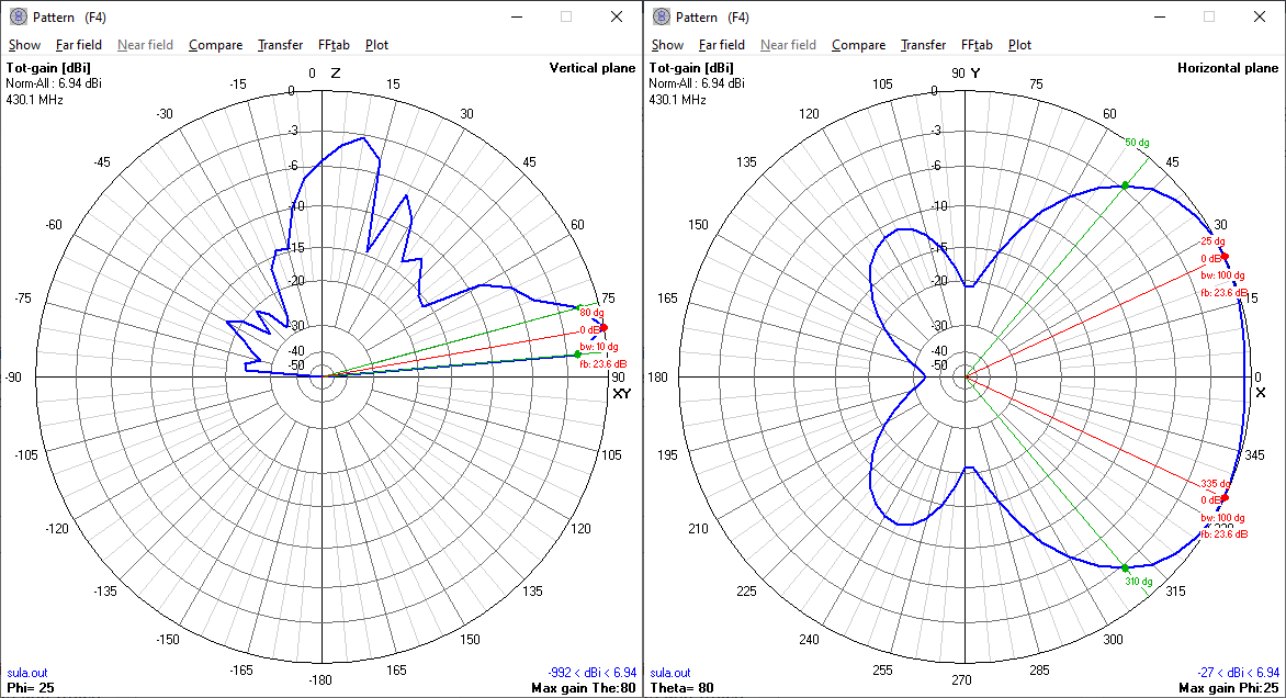

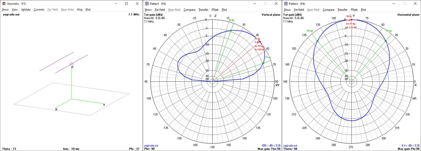

Just for the sake of discussion, let's take the 40m band, now a Yagi-Uda antenna for that band would have two elements with a total length of about 20m and a boom of about 5m, such an antenna installed at 10m from ground will have the following radiation pattern
now let's look at the radiation pattern of the small loop, installed at an height of just 3m on the same band
if we let aside the gain, which for a receive only antenna isn't the main factor, as field tests of the loop (and tests with the LoG and other antennas) demonstrated, I believe that the very small loop offers some remarkable features, even if compared to a big and high Yagi beam, as an example, look at the lower angle of the beam or at the front to back ratio, the latter is about 9dB for the Yagi and a whooping 29dB for the small loop, while the lower radiation angle is 20° from the horizon for the Yagi and 10° for the loop, if one considers that the Yagi is up at 10m from ground while the loop is just at 3m the thing is pretty remarkable, also considering the fact that to lower the Yagi angle down to 10° we should raise it at 1/2 wave, which, on the 40m band means about 20m from ground
forgot, for the curious ones, the NEC model for the Yagi-Uda antenna is this one

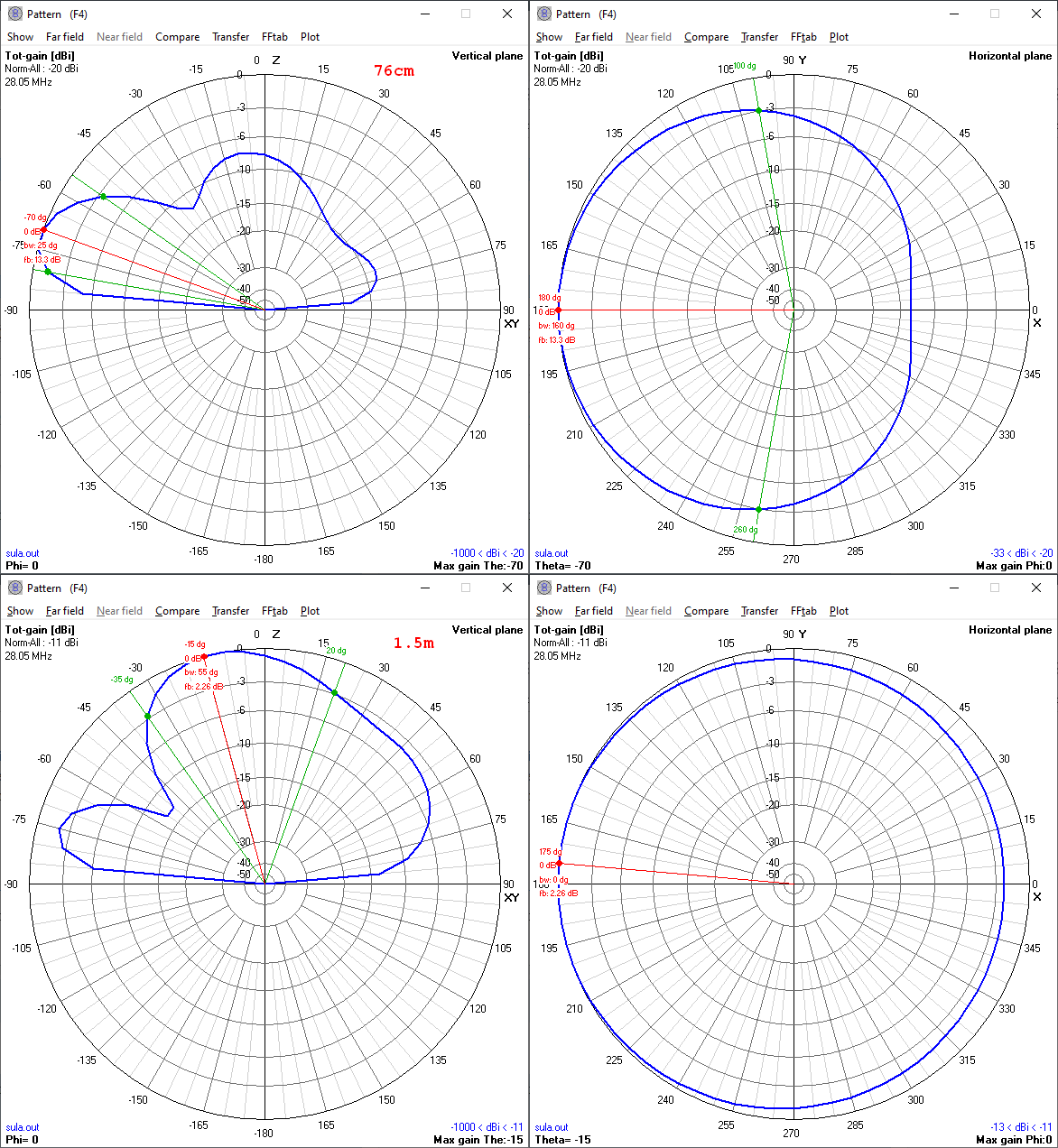

and running the model I got some interesting results, for example, here's the above NEC model on the 40m band
as you can see, the pattern is opposite to the SULA one (toward the resistor) and the backside "null" is missing, this isn't to say that the W2PM is bad, but the choice of routing the coax "inside" the antenna and the low height on ground, make a difference here, on the other hand the gain is -32dB, which is better than the SULA, but then the vertical beam is wider (5° from vertical), which means that the antenna will be sensitive to NVIS signals, now let's look at the SULA, the model is the following

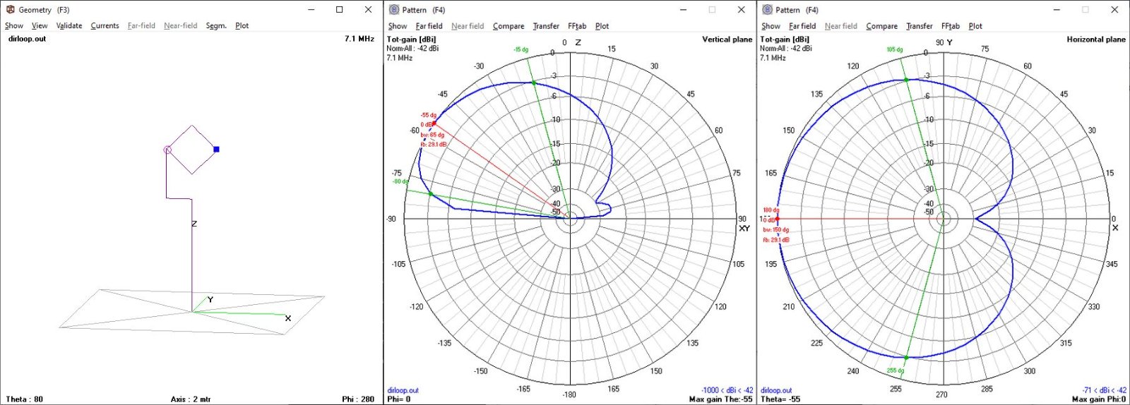

the antenna is smaller, since the SULA has a 76cm side, wherease the W2PM has a 1.5m one, also the SULA is placed higher since it's at 3m while the W2PM is just at 1m from ground (more on these later), but the SULA simulation results on 40m were the following
and I think that it's easy to see that, while the SULA shows lower gain (-42dB) it shows a deeper "null" at the back and that its vertical lobe is narrower, with a 15° angle from vertical, which makes it less subject to interference from NVIS signals, this, coupled with the backside "null" will help attenuating undesired signals (and noise)
Now, I ran a number of tests and frequency sweeps and the results of those are pretty clear to me, but I'm not going to post all the results, if you want, pick the two NEC models and run them yourself; by the way, it would be interesting if some of the designers or users of the W2PM could jump in here and discuss the thing, I believe that such a discussion may end with interesting results

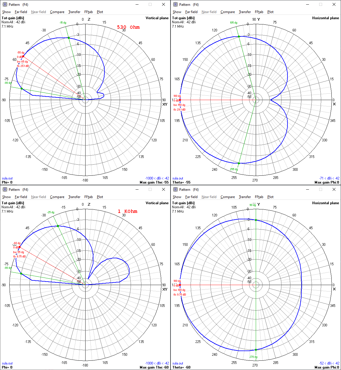

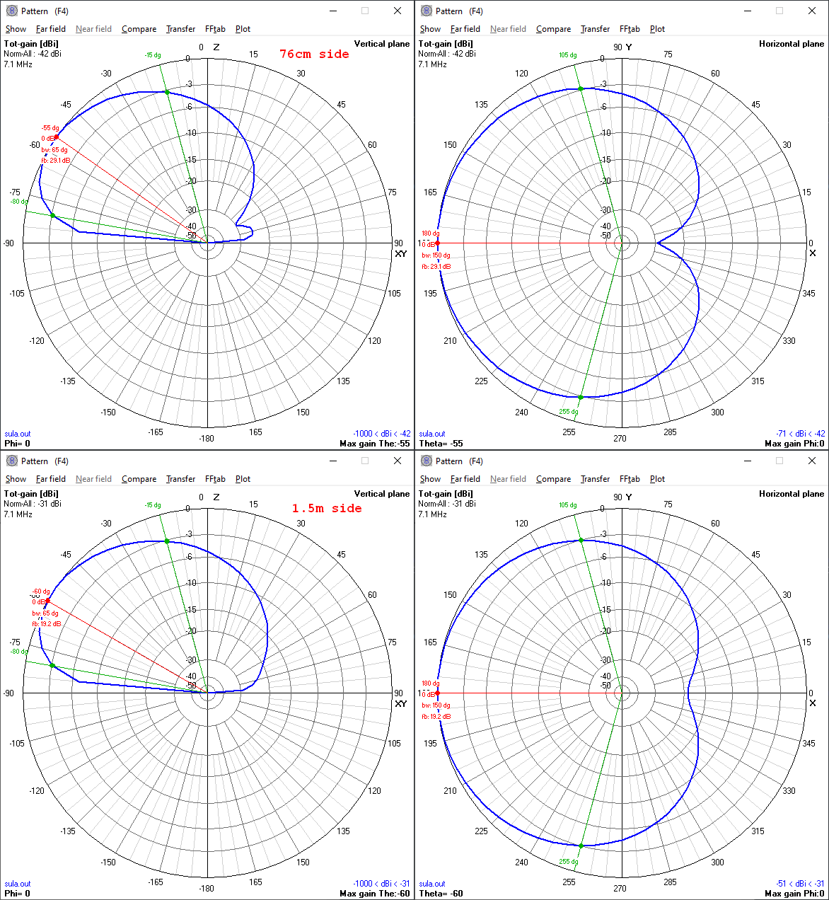

Let me start by saying that due to personal issues I can't run field tests at the moment, so my replies below are based on some NEC simulations, I hope that Ollie (13dka) will chime in and report his field data, all I can say is that till now, the results of NEC modeling the SULA reflected what Ollie observed during field tests, so I'm confident that what follows reflects the antenna behavior
Let's start from the FLG100N, that preamp has an embedded 16:1 impedance transformer at its input, so it claims for a higher resistor value to match the impedance, now, the image below shows what happens when we change the SULA resistor from 530 Ohm to 1 KOhm (I also tried 900 but the result won't change)
as you can see, the antenna pattern changes, the nice backside "null" disappears and the horizontal lobe widens to 180° so, sincerely I'd avoid such an approach; also, placing a 2:1 (ok 1:2 if we're going to raise the impedance) between the loop and the FLG100N preamp would mean having two transformers in series (our one and the one embedded inside the preamp) and, sincerely, I'm not sure about the effects such a thing could have (although I've some "suspects" and sincerely I don't think the setup will work well), that being said, you asked about size, now, let me start by showing you what happens when we change the SULA size
the above shows the standard (76cm side) SULA pattern and the pattern we obtain by raising the side to 1.5m, while the gain changes from -42dBi to -31dBi, the null starts disappearing, also, if we then try moving from 7MHz to (say) 28MHz the effect of the longer side (larger loop) will be the following
now, if one is only interested in the lower frequencies (say 7MHz and below), increasing the loop size may offer better gain, but if one is seeking for an "all rounder" receive antenna, which is small enough to be easily carried around or used even in case of restrictions (HOA and the like) and which doesn't need to be mounted high, then I believe that the current SULA design should fit pretty well, then for sure it may be possible to further optimize and improve it, but as is now it isn't bad, I think :D and, just as a note, here's the pattern of the SULA at 430MHz
as you can see, the lobe is reversed, that is points toward the resistor, but the takeoff angle and unidirectional lobe are pretty good, plus at those frequencies the antenna shows positive gain, so one may just omit the preamp :)

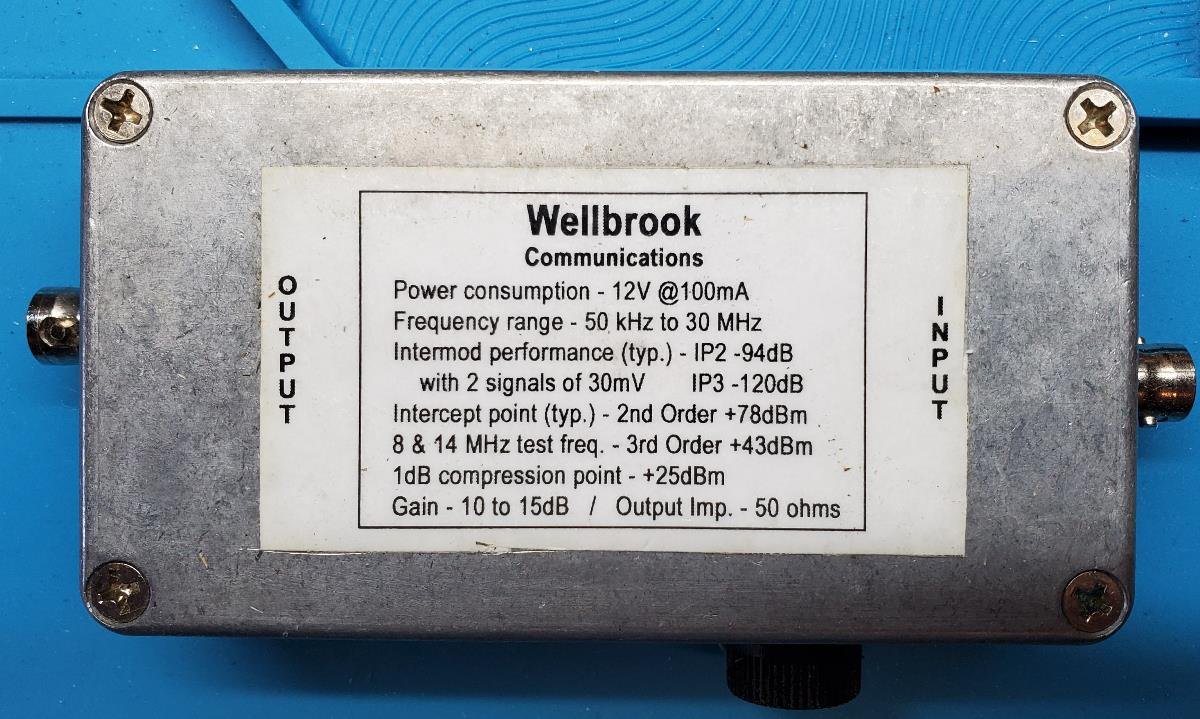

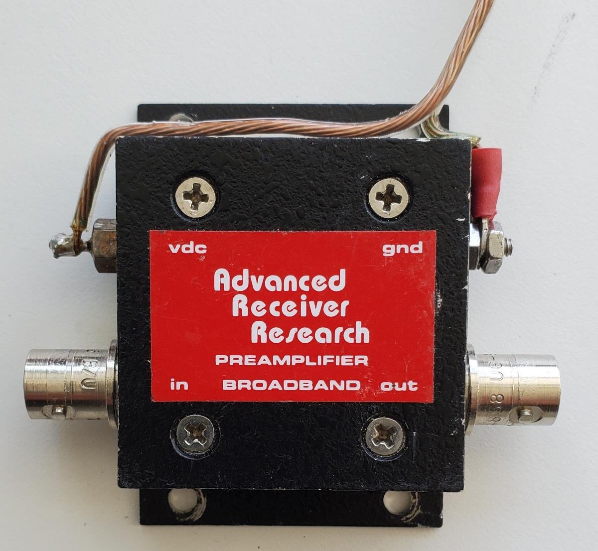

The places I DX from a few times a year have significant sea gain (coastal salt water) effect, so I suspect the SULA will perform well there even on the lower end of medium wave.
The 50 ohm preamps I currently have on hand are as follows. The Wellbrook module is an old one that I repackaged in an aluminum enclosure years ago, and added a label with the specs. It is 10-15 dB gain, not the 18 dB I mentioned earlier. Perhaps this one will not give enough gain?
The other amp is also an oldie from Advanced Receiver Research (USA). It is rated 20 dB gain, at the low end of what's recommended for the SULA. Both amps have a high 1-dB compression point so they work well in higher RF environments.
Unfortunately these amps are not set up for DC power via the coax (bias-T / voltage injector), unlike the other Wellbrook units I have (FLG100LN for instance). I would have to power them in the shack with 12 VDC, not ideal in my opinion. Locating the preamp at the mast would be better (I'm referring to home usage, where my coax run is about 100 feet long).
Wellbrook Amp.jpg (167.67 KiB) Viewed 129506 times

4nradio wrote: Thu Aug 25, 2022 1:09 am The places I DX from a few times a year have significant sea gain (coastal salt water) effect, so I suspect the SULA will perform well there even on the lower end of medium wave.
Some notes from "13dka" seem to indicate the same, given that his listening post is near the North Sea shore, so your will be another interesting experiment, please again, report back after your SULA tests

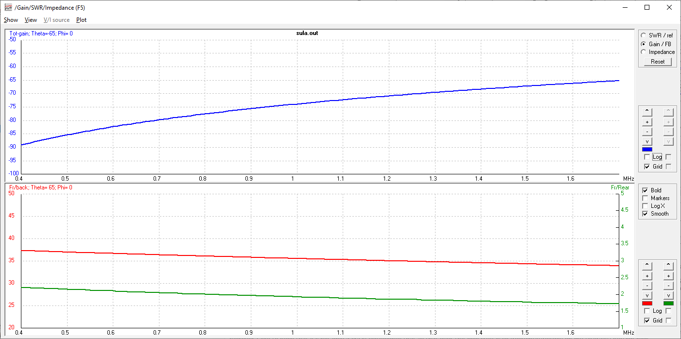

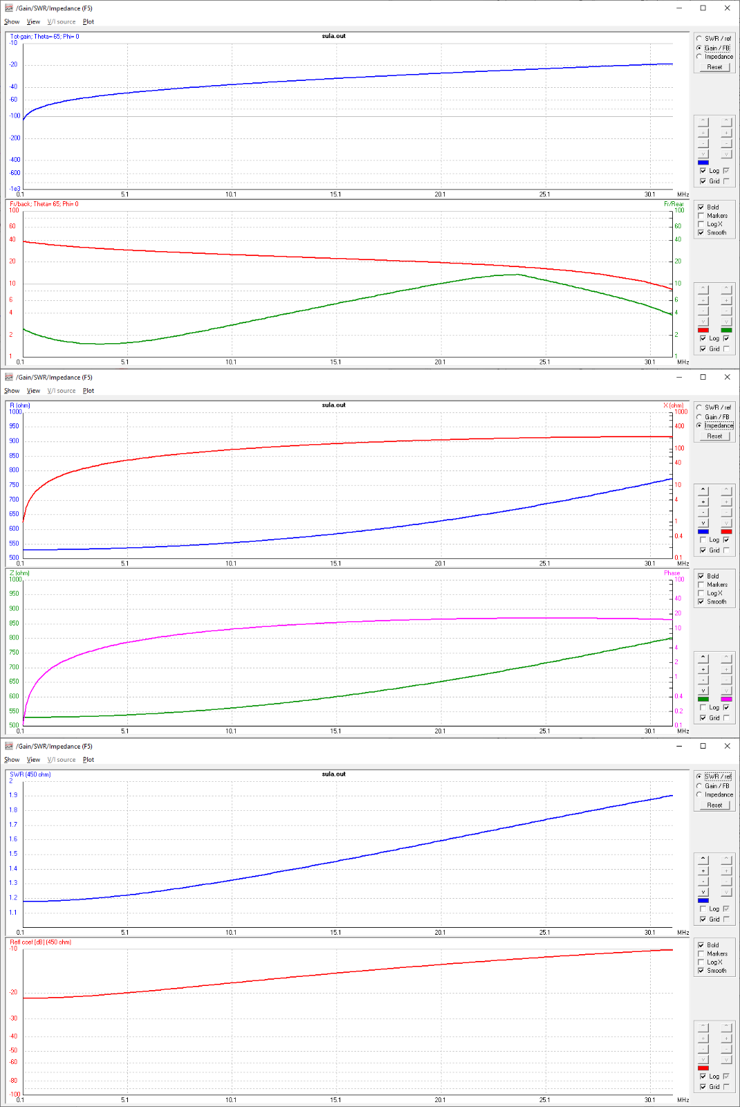

Well, the SULA curves, over the 0.1 ... 30 MHz range are the following
now, if you look at the gain curve (right click the image and open in a new tab to see it full size), you'll see that a 20dB preamp will fit pretty well, not that the gain here is really important, since we want to set the SNR, but a bit of boost is useful to have enough signal for the receiver; that being said, trying different preamps/gains would be another interesting experiment

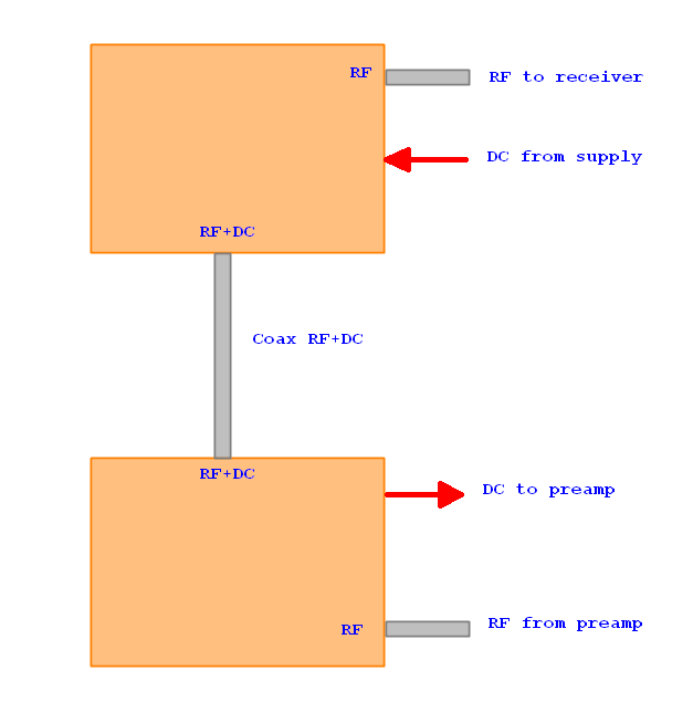

As for Bias-T, any device can be powered using a pair of Bias-T units :D ! There's no need for an embedded one, think at it for a split second, got it ?
If not, here's how it works
the upper Bias-T unit is at station side, the "RF" side of the Bias-T goes to the coax feeding the receiver and the DC connector to the power supply, the "RF+DC" side of the unit is then connected to the coax going to the antenna, at the other end of such coax (antenna side) we have a second Bias-T unit connected the OPPOSITE way, that is, the "RF+DC" is connected to the coax coming from the station, the "RF" side goes to the preamplifier, while the DC connector goes to the preamplifier power input
Easy, isn't it :D ? The only "problem" is finding an appropriate Bias-T unit, by "appropriate" I mean a Bias-T which will work over the desired frequency range, because see, a Bias-T unit is little more than an inductor and a capacitor as shown here

Just to be more clear, let's look at the SULA gain curve between 0.5 and 1.6 MHz (the MW band)
as we can see, the gain at 0.5MHz is -85dBi while at 1.6MHz it raises to -66dBi, this means that, using a 20dB preamp the gain will range from -65dB to -46dB which should be enough to allow a decent receiver to pick up signals on the MW band, on the other hand, the gain at 30MHz is -19dBi so those 20dB from the preamp aren't too high to worsen the SNR :)

Thanks for the reminder of back-to-back Bias-T boxes! I had forgotten that I can use them this way. I have an extra identical one to the Bias-T that's powering my ALA1530LN right now (not the Wellbrook supplied unit, but a ham-made pair of Bias-T's). These work well from MW on up.
