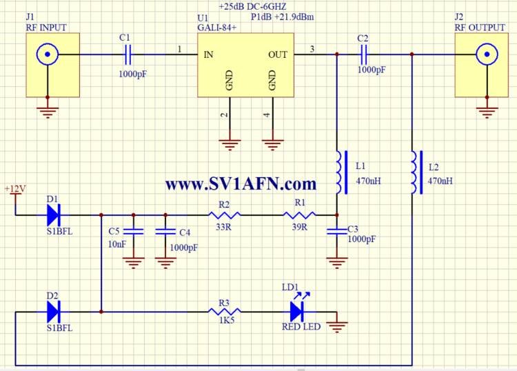

I got the replacement SV1AFN preamp today (the first one lacked an inductor :)) and gave it a brief indoor function test with the YouLoop.
First off, as expected it does not work with 5V so I'd have to rethink my preamp power supply for portable operation. With 12V it seems to have the nominal 20dB of gain but with what looks like a noticeable gradual gain increase with frequency and what looks like no gain at all on LW/MW:

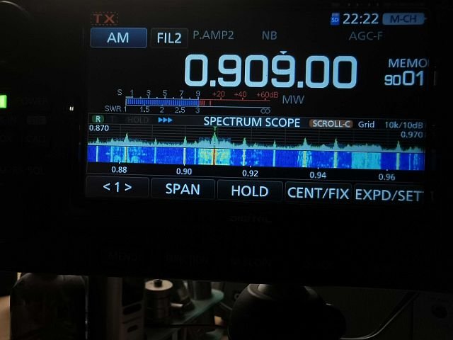

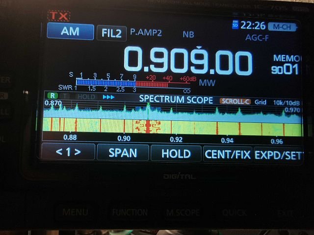

YouLoop passive on MW:
With the SV1AFN preamp I get little more than "unity gain" on MW:

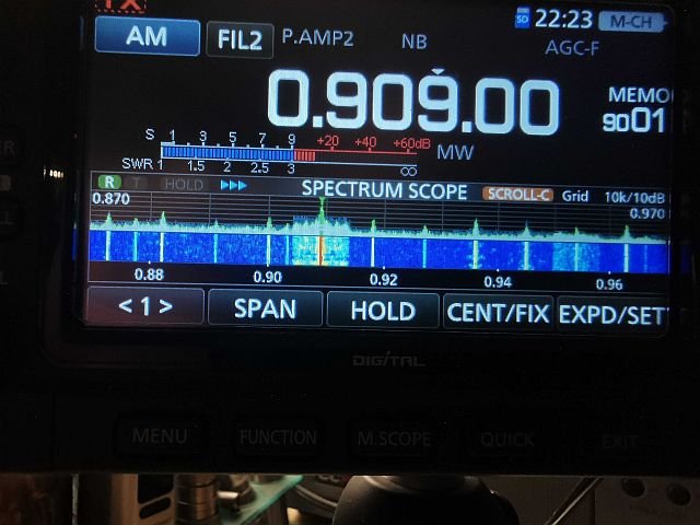

This is the LANA HF (5V) on MW:
A lot more gain down there. Since I had 12V available on the desk I decided to check for the first time what the LANA HF does with 12V. The short LANA HF manual states that it's supposed to work with 12V, even though "extended" operation with 12V is not recommended. I didn't intend to use it with 12V but I honestly expected it to survive more than 10 seconds, which it didn't. I attached the power supply to the Bonito CPI1000 bias-T unit, the LANA came on but with very little gain, I disconnected the power, checked the connections and plugged the 12V back in, it came on again and then the LED on the LANA went out. :(

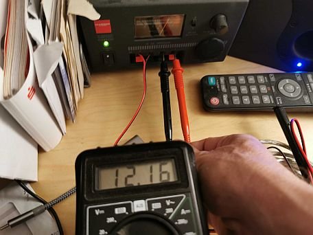

I double-checked the power supply output:
Yet the LANA HF was dead, the third one altogether (NooElec was very helpful and replaced the first 2, of which 1 died while testing it on the SULA, the other one lost a few dB of gain elsewhere since I bought it).

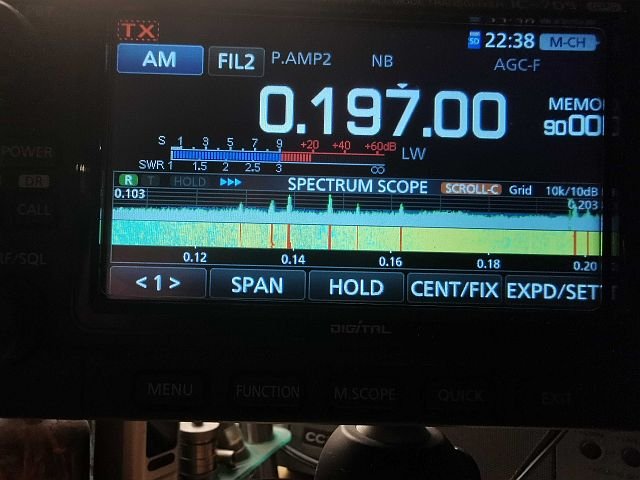

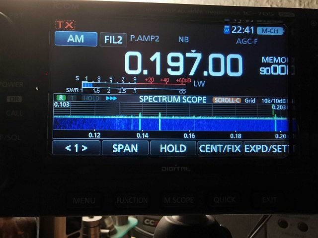

Moving on, here's the SV1AFN preamp on LW:
The remaining LANA HF:
Of course I have yet to test the SV1AFN properly at the dike, particularly because the "visual" gain does not say much about the actual reception but it could turn out to be of somewhat limited use for the SULA this way. It also gets pretty warm and I'm afraid that means it will drain the battery a lot faster than the LANA HF. The LANA HF might be a bit sensitive (the other one died after A/B switching SULA and reference antenna a few times) and I guess I have to bite the bullet and order the W7IUV 2N5109 preamp or the 2SC5551 equipped model too, which burns up battery for the relays we don't really need for RX-only operation. The 2SC5551 model seems to have a particularly low noise figure which is certainly interesting.

13dka wrote: Mon Sep 12, 2022 9:52 pm I got the replacement SV1AFN preamp today (the first one lacked an inductor :)) and gave it a brief indoor function test with the YouLoop.
This is strange, see, the GALI-84+ declares an operating range (and gain) from DC to 6 GHz, and the SV1AFN web site says that that preamp works from LF up to 4GHz; did you try mailing SV1AFN and asking some clarification ? as for the 12V, the GALI datasheet states that the IC operating voltage is around 6V, but if you then look at the SV1AFN schematic
we can clearly see that the preamp wants 12V, this is probably due to R1/R2 which are dropping the voltage (the power comes from the Bias-T formed by C2/L2); also, looking at the circuit, the frequency range limit is most probably set by C1/C2 and L1/L2, but then given that SV1AFN states that the unit works from LF, the fact that it has very little gain down on MW seems strange

Nooelec wrote: Though there is protection circuitry on LaNA HF Barebones for overvoltage conditions--and voltages of up to 12V DC should still work and will not damage the device--it is not recommended for long-term usage. Kindly note that damage resulting from overvoltage conditions would not be covered under the standard warranty.
I wouldn't have tried that otherwise. BTW the image shows the Bias-T input voltage, the voltage on the ANT jack is 0.2-0.3V lower. I hope to get the SV1AFN preamp tested with the SULA at the dike tonight, Maybe that's just some interaction with peculiarities of the YouLoop I'm seeing there.

I wish you were right.:/ I tried the preamp at the dike with the SULA tonight and it looked like it has indeed (more or less) a similar gain curve as the SULA, weak on MW and better with increasing frequency. The result was basically no reception on LW, very little on MW, still pretty bad on 20m and the "break-even point" (where the gain was comparable to the LANA HF) was on 10m. So it looks like something isn't right with that preamp but I'm going to check the coax and connectors tomorrow to make sure there isn't something off on that side, how much voltage is left on the other end of 15m coax etc.. before I contact Makis again (I really hate being a high maintenance customer!).
After I swapped the preamps and batteries everything was back to normal though and I enjoyed the general function of the antenna with some pretty healthy signals from the US. Everything from the east was pretty weak though and when I tried to peak the very weak signal of AUS VOLMET on 11387 kHz I had this situation again where thunderstorms over France and Spain were for the most part ending up in the backside minimum. Turning the antenna a little to the side didn't reduce the signal from Australia but lots of crashes started triggering the AGC and made it hard to hear the station until I turned it back. This really is a fun antenna. :)

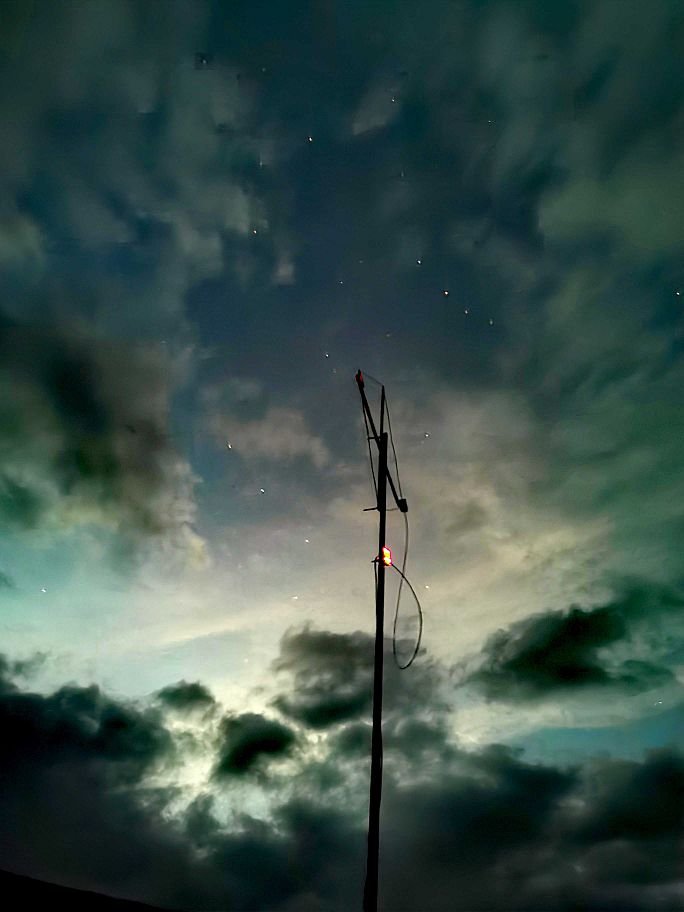

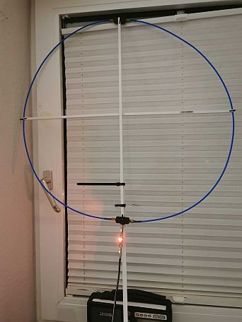

(I usually take a pic of the antenna when I set up the station at the dike so I know later what recordings were made with what antenna, tonight I got this dramatic picture.)

13dka wrote: Wed Sep 14, 2022 12:09 am I wish you were right.:/ I tried the preamp at the dike with the SULA tonight and it looked like it has indeed (more or less) a similar gain curve as the SULA, weak on MW and better with increasing frequency. The result was basically no reception on LW, very little on MW, still pretty bad on 20m and the "break-even point" (where the gain was comparable to the LANA HF) was on 10m. So it looks like something isn't right with that preamp but I'm going to check the coax and connectors tomorrow to make sure there isn't something off on that side, how much voltage is left on the other end of 15m coax etc.. before I contact Makis again (I really hate being a high maintenance customer!).
SIGH !! I doubt the issue may be due to voltage, although the fact that the preamp doesn't perform even going up to 20m isn't normal imHo, add to this that the preamp is sold as "LF to GHz" and, sincerely, there's something not "matching" here, I understand your point, but I believe that asking Makis for help/infos may be the right thing to do
Well, at least that demonstrated that the SULA needs a decent preamp, as for crashes from thunderstorms, the only antenna I'm aware of, which is capable of attenuating them is the LoG, yet the backside "null" of the SULA seems to have some effect on those :D
Hey, a "cross" against dark stormy clouds is something :D !
