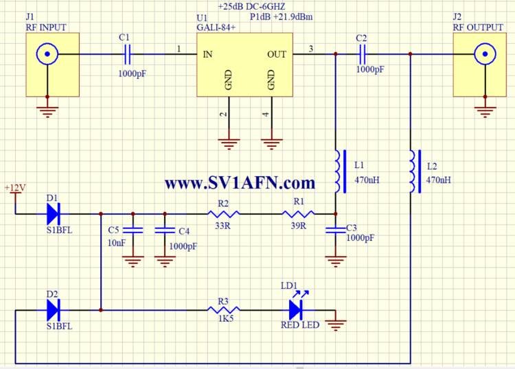

I got the replacement SV1AFN preamp today (the first one lacked an inductor :)) and gave it a brief indoor function test with the YouLoop.
First off, as expected it does not work with 5V so I'd have to rethink my preamp power supply for portable operation. With 12V it seems to have the nominal 20dB of gain but with what looks like a noticeable gradual gain increase with frequency and what looks like no gain at all on LW/MW:

13dka wrote: Mon Sep 12, 2022 9:52 pm I got the replacement SV1AFN preamp today (the first one lacked an inductor :)) and gave it a brief indoor function test with the YouLoop.
This is strange, see, the GALI-84+ declares an operating range (and gain) from DC to 6 GHz, and the SV1AFN web site says that that preamp works from LF up to 4GHz; did you try mailing SV1AFN and asking some clarification ? as for the 12V, the GALI datasheet states that the IC operating voltage is around 6V, but if you then look at the SV1AFN schematic
we can clearly see that the preamp wants 12V, this is probably due to R1/R2 which are dropping the voltage (the power comes from the Bias-T formed by C2/L2); also, looking at the circuit, the frequency range limit is most probably set by C1/C2 and L1/L2, but then given that SV1AFN states that the unit works from LF, the fact that it has very little gain down on MW seems strange

if the gain is so low down at MW, I've little hope the SV1AFN will be so useful for the SULA, on the other hand, I believe that asking SV1AFN some clarification about the low gain may be due
At this point, it remains to see which preamp may be suitable for the SULA, the LANA-HF isn't bad since it demonstrated to work and since it's widely available, but having more choices would be nice, I was looking at some preamps which look interesting, but they aren't commercial ones, and even if some of them may be available through various sources, they aren't easily found as the NooElec <sigh>

Posted: Tue Sep 13, 2022 12:43 pm
13dka wrote: Tue Sep 13, 2022 11:41 am I hope to get the SV1AFN preamp tested with the SULA at the dike tonight, Maybe that's just some interaction with peculiarities of the YouLoop I'm seeing there.
Uhmmm... I missed that <sigh> ... ok, the NCPL (YouLoop) impedance is FAR AWAY 50 Ohm, the 1:1 BalUn there is only used to keep the loop balance (to some extent, there's a mod improving that, but that's a different topic) so the SV1AFN is seeing a (probably large) input impedance mismatch and that may explain why it isn't playing well, if that's the case, then the preamp should work better with the SULA, since the latter has good impedance match over the whole operating range

I wish you were right.:/ I tried the preamp at the dike with the SULA tonight and it looked like it has indeed (more or less) a similar gain curve as the SULA, weak on MW and better with increasing frequency. The result was basically no reception on LW, very little on MW, still pretty bad on 20m and the "break-even point" (where the gain was comparable to the LANA HF) was on 10m. So it looks like something isn't right with that preamp but I'm going to check the coax and connectors tomorrow to make sure there isn't something off on that side, how much voltage is left on the other end of 15m coax etc.. before I contact Makis again (I really hate being a high maintenance customer!).

13dka wrote: Wed Sep 14, 2022 12:09 am I wish you were right.:/ I tried the preamp at the dike with the SULA tonight and it looked like it has indeed (more or less) a similar gain curve as the SULA, weak on MW and better with increasing frequency. The result was basically no reception on LW, very little on MW, still pretty bad on 20m and the "break-even point" (where the gain was comparable to the LANA HF) was on 10m. So it looks like something isn't right with that preamp but I'm going to check the coax and connectors tomorrow to make sure there isn't something off on that side, how much voltage is left on the other end of 15m coax etc.. before I contact Makis again (I really hate being a high maintenance customer!).
SIGH !! I doubt the issue may be due to voltage, although the fact that the preamp doesn't perform even going up to 20m isn't normal imHo, add to this that the preamp is sold as "LF to GHz" and, sincerely, there's something not "matching" here, I understand your point, but I believe that asking Makis for help/infos may be the right thing to do
