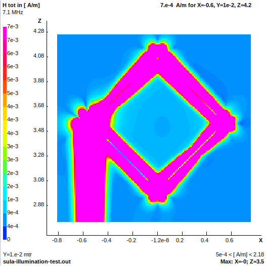

There seems to be a very small magnetic shadow effect visible in the SULA.
When illuminated from the front (non-null) side by a small vertical dipole located at x=-100, the magnetic near field inside the loop has a moderate field intensity, indicated by the light blue color.
- sula-illumination-front.png (53.25 KiB) Viewed 53903 times

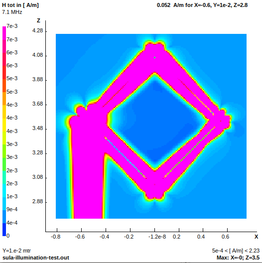

When illuminated from the rear (null) side by a small vertical dipole located at x=100, the magnetic near field inside the loop has a weaker field intensity, indicated by the darker blue color. This is the magnetic shadow effect.
- sula-illumination-rear.png (53.74 KiB) Viewed 53903 times
