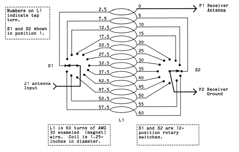

Some years ago I had exactly the same problem as you. A friend adviced me to build a simple antenna tuner, and a quick search on the internet resulted in a link to a building instruction for an antenna tuner in PDF format by someone calling himself Editor Bob.
Since then I have built two more of these tuners, since the result was very satisfactory.
I was not able to attach the PDF, seems like the forum accepts bitmaps only as attachments. So attach a screendump of the scematic. If I only knew your email adress, I would be happy to send you the PDF.

Thanks for all the ideas. I thought that since this antenna was so common (Radio Shack has surely sold thousands, not to mention the Philmore branded versions) there might be a quick, well-known choice. I may try the tuner design in Andrew's first reply. Funny how well the End-fedz works without a counterpoise, though the coax is grounded at both ends with 8' copper-plated rods. Thanks again!
