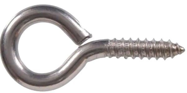

What do you think of this one? https://www.nooelec.com/store/balun-one-nine-v2.html It's only a couple of bucks more and is (for the most part) already enclosed. It could easily be attached with a 3M Command Strip.
These eye hooks look pretty good for the wire as well..

the box doesn't need to be big, since it will just host the balun and the chock block or (the other box) just the resistor(s), as for the eye hook, it's ok, but don't pass the wire inside the eyelet, suspend the wire using a loop made with nylon cable ties, antennas don't like metallic objects :D

by Omega-TI
Andrew (grayhat) wrote: Thu Feb 01, 2024 3:30 pm
"... suspend the wire using a loop made with nylon cable ties, antennas don't like metallic objects :D"

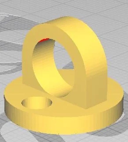

Yeah, but I'm trying to be as stealthy as possible. I think I'll go with a few 3D printed eyelets printed in the same color as the building.
