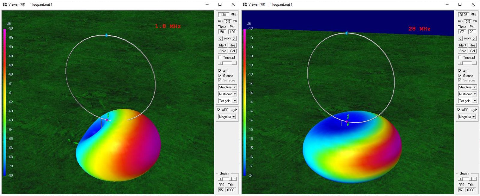

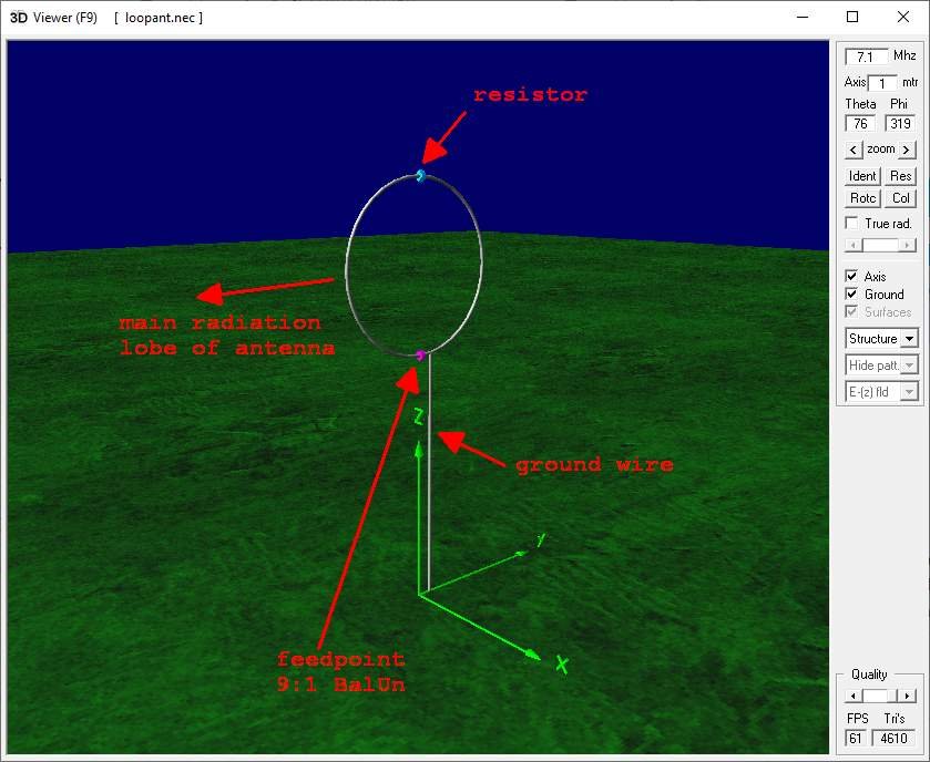

the antenna is a circular loop with 1m diameter placed at 1.20 m from ground (if placed higher the directional pattern will get lost when going up in frequency), the loop is broken at the top and the two halves are connected using a 510 Ohm resistor which allows to present a feedpoint impedance around 450 Ohm over the whole range, one of the halves of the loop is also connected to ground at the feedpoint, through a run of wire going straight down to a ground stake
- card_loop1.jpg (84.94 KiB) Viewed 45291 times
the wire, together with the top resistor, gives to this antenna its directional pattern

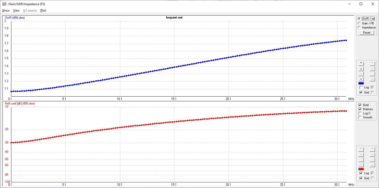

as you can see, the pattern is somewhat less "marked" at 28 MHz, but it's still there and there's a good "null" at the back, so the resulting antenna should serve pretty well on the whole SW range, and then, thanks to the resistor and the optimization, the SWR curve at 450 Ohm (9:1 BalUn) is pretty good
- card_loop3.jpg (151.9 KiB) Viewed 45291 times
which means that, with a 9:1 BalUn, the antenna will match pretty well whatever "off the shelf" preamplifier or can be directly connected to any receiver w/o problems
After some further simulations, I found that raising the loop to 1.20m from ground helps mantaining the F/B directional pattern on the whole SW range; also, thinking about the idea of modifying the MLA-30 into a "cardioid loop", I got back to the G8JNJ page describing the MLA-30
