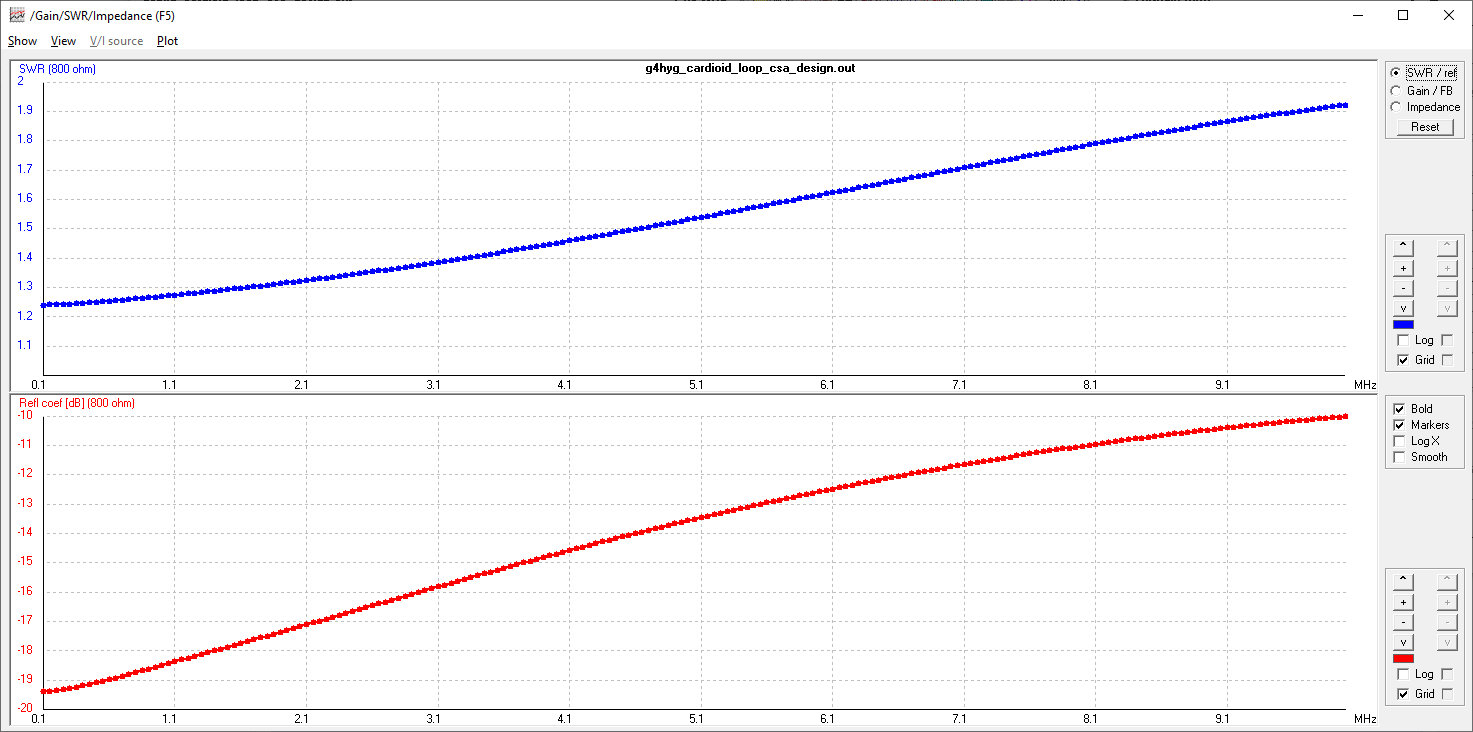

Ok, being curious decided to download the NEC model file from the CCW page and ran it, found that the impedance of the antenna in the range between 1KHz and 10MHz varies between 600Ohm and 1KOhm, so I ran a sweep setting the feeder impedance to 800Ohm that is feeding the antenna through a 16:1 BalUn, the result is the graph below (full image: download/file.php?id=16)
which shows a pretty good curve, this means that winding a BalUn with a 16:1 transformation ratio (4:1 turns ratio) will allow to use whatever preamp which accepts a 50Ohm input :D ! Also, the NEC simulation confirmed the cardioid pattern, so the antenna may really be worth a try, also since a beam antenna for those low frequencies isn't exactly a "little thing" :D
Notice that the BalUn may be built following the same design used for the NCPL antenna but changing the primary/secondary turns to obtain a 4:1 turns ratio, for example 8 turns toward the antenna and 2 turns toward the coax, the resulting balun will have an impedance transformation ratio of 16:1
Note: the NEC model on the page is for the LARGER version of the loop (optimized from 1.8MHz and down), the smaller one presents a feedpoint impedance between 100 and 200 Ohms so a 2:1 or 4:1 BalUn will fit in such a case

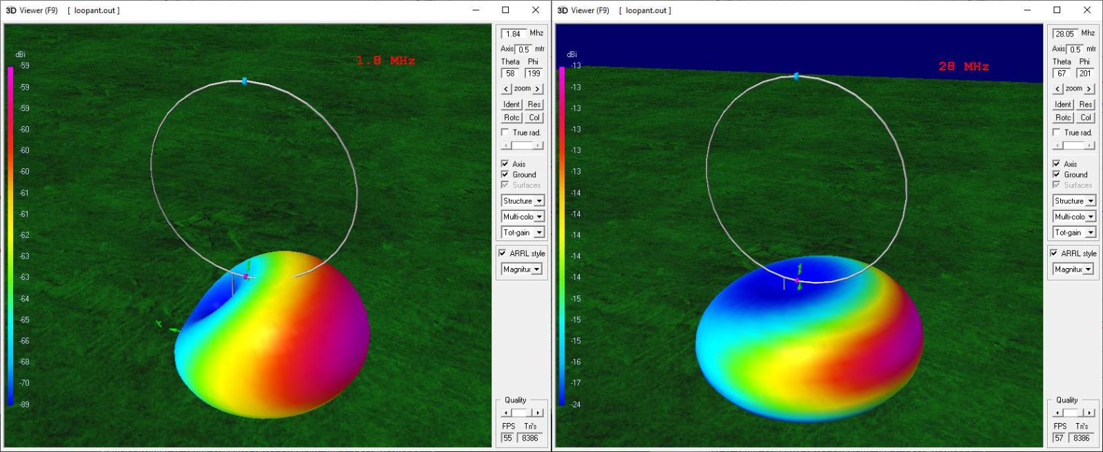

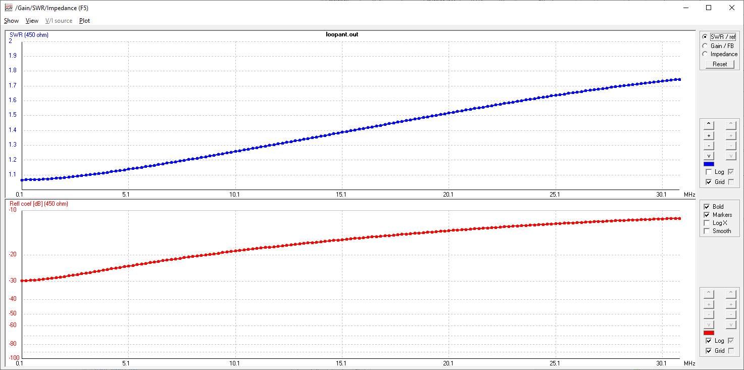

as you can see I changed the loop size to be a square with a 1m side, placed at 1.5m above ground and with a 160Ohm resistor, the resulting loop has an impedance around 200 Ohm and can be fed using a 4:1 BalUn, the cardioid pattern is the same so the antenna retains the directional characteristics, given the pretty low gain, a preamp may be needed, although it may be interesting to experiment without it
here are some graphs from the NEC simulation (click on the image for full size)
which show the antenna structure, pattern and the impedance/SWR graphs, the reactance of the antenna could be lowered by raising the resistor value to around 330Ohm but then the pattern will loose some directionality, so I'm not sure it may be a good idea

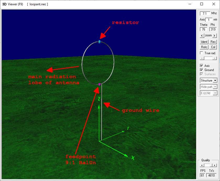

the antenna is a circular loop with 1m diameter placed at 1.20 m from ground (if placed higher the directional pattern will get lost when going up in frequency), the loop is broken at the top and the two halves are connected using a 510 Ohm resistor which allows to present a feedpoint impedance around 450 Ohm over the whole range, one of the halves of the loop is also connected to ground at the feedpoint, through a run of wire going straight down to a ground stake
the wire, together with the top resistor, gives to this antenna its directional pattern
as you can see, the pattern is somewhat less "marked" at 28 MHz, but it's still there and there's a good "null" at the back, so the resulting antenna should serve pretty well on the whole SW range, and then, thanks to the resistor and the optimization, the SWR curve at 450 Ohm (9:1 BalUn) is pretty good
which means that, with a 9:1 BalUn, the antenna will match pretty well whatever "off the shelf" preamplifier or can be directly connected to any receiver w/o problems
After some further simulations, I found that raising the loop to 1.20m from ground helps mantaining the F/B directional pattern on the whole SW range; also, thinking about the idea of modifying the MLA-30 into a "cardioid loop", I got back to the G8JNJ page describing the MLA-30
