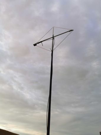

I"m out at the dike, forgot the power bank to feed the pre-amp. It appears like this thing really needs one, other than that, it"s a strange animal for sure, not quite as calculated and it's too soon to tell anything definitive but it seems to show some interesting traits. Will report tomorrow. 13dka out. :)

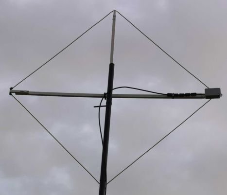

Long (!) version: Of course you know that one can't fully assess an antenna in one night, unless it's radically different from the antenna it's being compared with. I compared it with the LoG because I'm very familiar with its performance (and I needed the pole for the SDL) and the SDL is supposed to perform not radically different from that in terms of DX aptitude. The results of last night are quite mixed and need some interpretation. Let's start with the bad stuff:

This is really odd: I rotated the antenna like a champion (of which I have almost nothing "on tape" because that requires getting out of the car and squinting on the S-meter while turning the pole) and it generally worked on LW/MW and above in the evening. In the morning, on the other side of the greyline, I rotated my butt off and yielded zero results on the higher bands, as in the nulls were gone. 20dB F/B ratio is like 3 S-units and therefore hard to notice but the nulls are noticeable for sure, as demonstrated (OK difficult to see) in the next video, shot in the evening. Balun box pointing to the right = North, pointing to the left = South, station is CN8YZ in Morocco on 15m:
But these nulls seemed to have disappeared in the morning. Maybe it's just 20m where they don't show up so much in general. A different theory is that the antenna is very sensitive regarding the ground it stands on, and the tide is changing the close environment within the relevant 10 Lambda zone a lot.
Now to the encouraging things: First off, the SDL is indeed even worse than the LoG on LW, but it's actually better on MW! Here's an example showing more the unidirectional advantage than the better levels in the beam direction but this is quite nice - Radio Caroline playing the blues vs. Radio Murski Val (?) from Slovenia attacking Europe with accordeons on 648kHz, that's Southwest vs Southeast, the antenna turned Northwest:

So my preliminary summary of the performance is a careful "promising". That a 2 square foot loop can do what the 20 square foot LoG can do and then some is certainly asked much but I'll see Tuesday or Wednesday night (when it's too hot to be at home anyway). I have yet to try it much more and practice putting it up: I know it's a symmetrical antenna with galvanic separation so this shouldn't matter much but I tried flipping it around indoors and got the impression that there is a tiny difference, so I tried to make sure I have the "RF" side up and the other one down by marking it. But there were tourists with their kids nearby and I was eager to get it up as quickly as possible...
