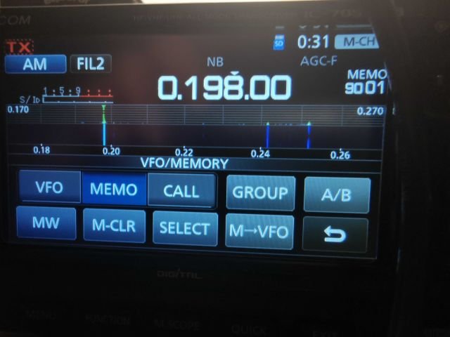

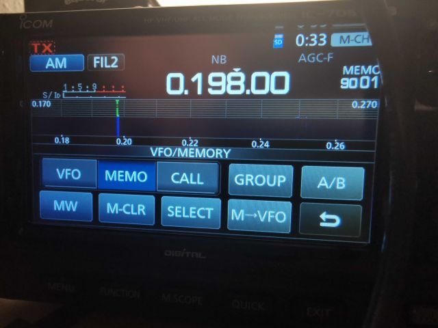

Last night the condx had recovered to a degree that 10m was good for some EU contacts and some more US signals returned. Alas the planned comparison with the amplified YouLoop didn't happen due to some location-related problems (illegal campers just on "my" spot at my listening post) so I moved to the alternate listening post a few km down the coast. There it turned out that some camping ground ~1km south of my position has installed some digital crap in the meantime, showing up faintly on the waterfall all over the SW. I was pretty annoyed but a little wrist-twist on the pole made that go away completely and that felt pretty good. I decided to just play with the SDL and gain more experience with it.
I was pretty puzzled that the 3V setting didn't yield the expected gain from the LANA HF tho, turned out this evening that the 2 examples I have are behaving differently - the second one I bought has ~6-10dB less gain than the other. Grrr. I was considering making a 2nd prototype to have an ideal reference for tweaks but this isn't fun if the LNAs don't do the same.
LANA HF #1 on 3V: LANA HF #2 on 3V: LANA HF #1 on 5V: LANA HF #2 on 5V: With the reduced gain MW looked even more bland than on the last attempt at the dike (with the better LNA) but browsing the band it dawned on me that what I was seeing on the waterfall was the yield of a beam turned NW, covering the remaining British stations more than anything else, and they were all there of course, including various local-ish private stations. Of course, it's still not that brilliant that it could bring in these stations during the day like my CCR2E would. Shortwave was not really something to phone home about but the IBP scans were plausible for the condix and brought the expected signals (Mt. Umum readable, KH6 not so much but WWVH was almost readble) in the morning, just as the LoG or vertical would have I guess.

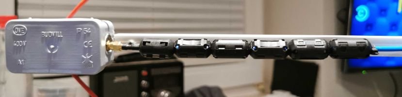

Today I used a 50cm piece of rigid RG-402 I sourced to put the choke right behind the balun. I'm guessing that the number of ferrites is half of what's needed to be effective but the antenna is already not very balanced (edit: weight-balanced that is) anymore. Also to show why these plastic cable duct profiles are a good choice to make the support structure :

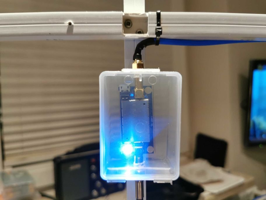

Here's the new LNA position:

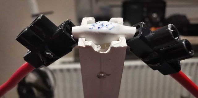

Resistor pack detail:

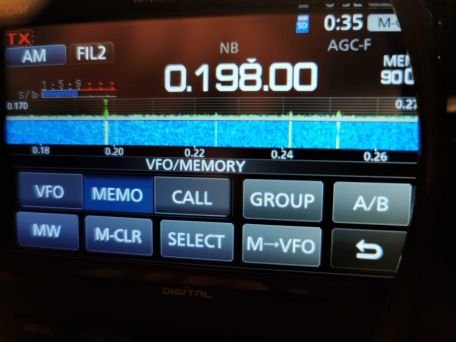

Not sure/no idea if that choke made any difference but here's RAI Milano 900kHz when I rotate the antenna indoors (the pronounced null is exactly where it should be!):
