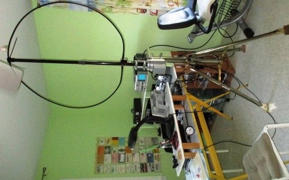

I've used a W6LVP loop in the past and was very pleased with the performance. Attached is a photo of it (from a few years ago) in the shack installed on a tripod with an RCA rotor. Eventually I moved the antenna outdoors for even better reception. It's an active antenna with a preamp. Don't know what the current price is but it's well within you range. You can also check antenna reviews on eham.net. Good luck on your move and choosing a new antenna.

Wideband active loops work well, but... did you ever try a tuned active loop ?N2HUN wrote: ↑Fri Jun 10, 2022 10:36 am I've used a W6LVP loop in the past and was very pleased with the performance. Attached is a photo of it (from a few years ago) in the shack installed on a tripod with an RCA rotor. Eventually I moved the antenna outdoors for even better reception. It's an active antenna with a preamp. Don't know what the current price is but it's well within you range. You can also check antenna reviews on eham.net. Good luck on your move and choosing a new antenna.
http://techlib.com/electronics/antennas.html
