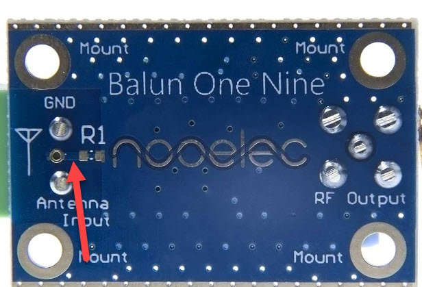

Balun One Nine: cutting R1

Post by rjzastaury »
Or here?
Re: Balun One Nine: cutting R1
that one is the V2, no need to scrape anything it does not have the center tap even if the PCB shows it :)
Interesting. Thanks, Andrew.
