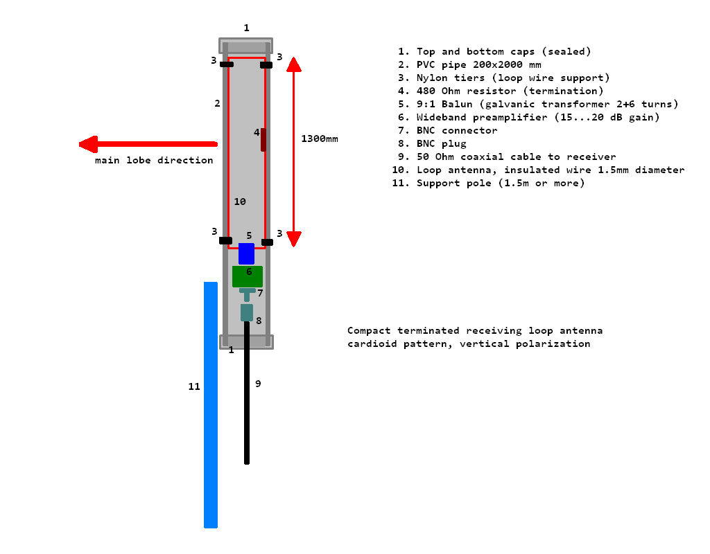

As for the antennas, I believe that the "pipe" may be able to survive harsh weather better than the SULA, if you look at the image, you'll notice that everything is enclosed/protected by the pipe, including the coax connector, and then the pipe is small enough (assuming the original sizes are used) to stand to winds w/o issues, plus given the geometry, it's possible to use a lightweight antenna rotator to aim it

For the interested ones, here's another idea to build the compact loop, the attached image shows all the relevant details, the resistor may be a regular one (although a non inductive one would be better), the 9:1 can be the commercial NooElec BalUn or can be built using a #73 binocular core, the PVC pipe encloses the antenna and the other components protecting them from atmospheric agents, the bottom part of the pipe (below the loop to avoid unwanted coupling) is tied to the support pole using steel cable ties and nuts+bolts (not shown in the drawing), the antenna should be installed at least at 1.5...2 meters from roof or ground; choosing a gray PVC pipe the resulting antenna may be easily disguised as a "weather station sensor" for the ones living in "antenna restricted" areas (read HOA) ;) also, the antenna is unidirectional (cardioid pattern) so it must be aimed to the desired direction, willing to use a rotator, a small one, like the ones used for TV antennas will fit, also since the antenna offers pretty low "load" against the wind, the top and bottom caps and the holes used for the nylon ties supporting the loop wire must be sealed using silicon or other suitable sealant to avoid issues due to humidity (rain, mist, fog) or due to ... insects :) the pipe is 200x2000 mm but if needed it may be shortened a bit or, willing to build a portable version, it may be spliced in two or three sections to ease carrying the antenna

tried it, works as described, less gain than the SULA but much easier to carry around and for permanent setups more resistant to winds
