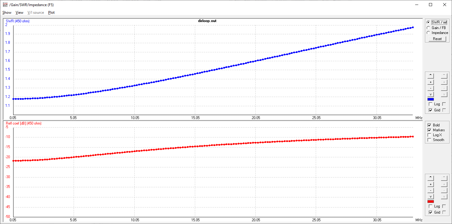

As a note, the difference between a 530 Ohm or a 540 Ohm load resistor is negligible, so 2x270 Ohm resistors in series will just fit, the resulting SWR curve between 0.05 and 33.05 MHz
shows that the antenna presents a good match over the whole range, this as I already wrote, allows to use whatever preamp (after the 9:1 BalUn) and in any case, offers a good match to the receiver and minimizes cable losses caused by mismatch
