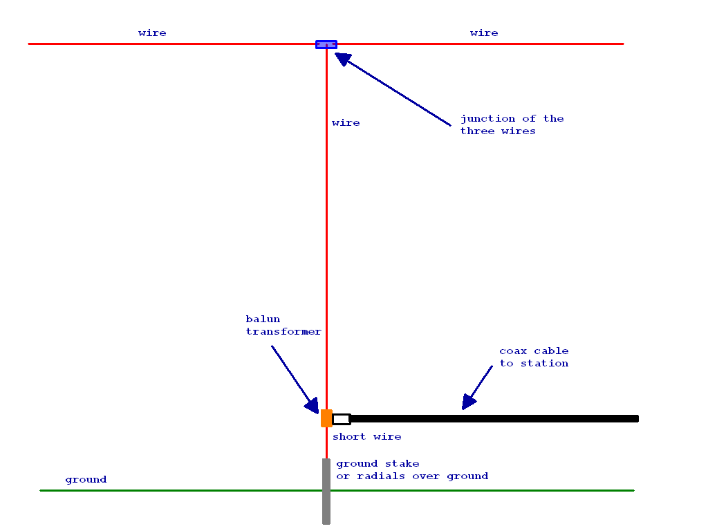

I presume the coax to the antenna counts as the vertical part of the T?
No, Jock !
The antenna is made using three wires, two wires forming the horizontal "arms" at the top and a wire forming the vertical portion of the antenna and dropping down from the horizontal wires junction to (near) ground, at that point, you'll either install a ground stake or a number of on ground radial wires (same length as the horizontal ones at top, number between two and whatever you can afford); between the vertical wire and the ground stake (or radials) you connect your BalUn and from there you start the coax going to the station; to be more clear, here's how the antenna is made (no masterpiece of art :D)
the horizontal wires and the vertical one are connected together at top to form a "T", at bottom of the vertical wire you connect your balun, one side to the vertical antenna wire, another side to the ground stake or, if you can use radials, to the radials (don't use both, either the stake or the radials), the radials, if used will be laid on ground and should be more or less symmetrical, at minimum use two radials aimed as the top horizontal section, otherwise just hammer down a stake in ground and connect it; the difference will be in terms of gain, it will be somewhat higher if using radials, lower if using the stake
hope it's clear now, if not just ask !

Now, keep in mind that the antenna (radiator) is the vertical wire, the horizontal arms at top act as a capacitive hat, their effect is to make the vertical wire appear longer at RF and also to lower the radiation angle of the antenna

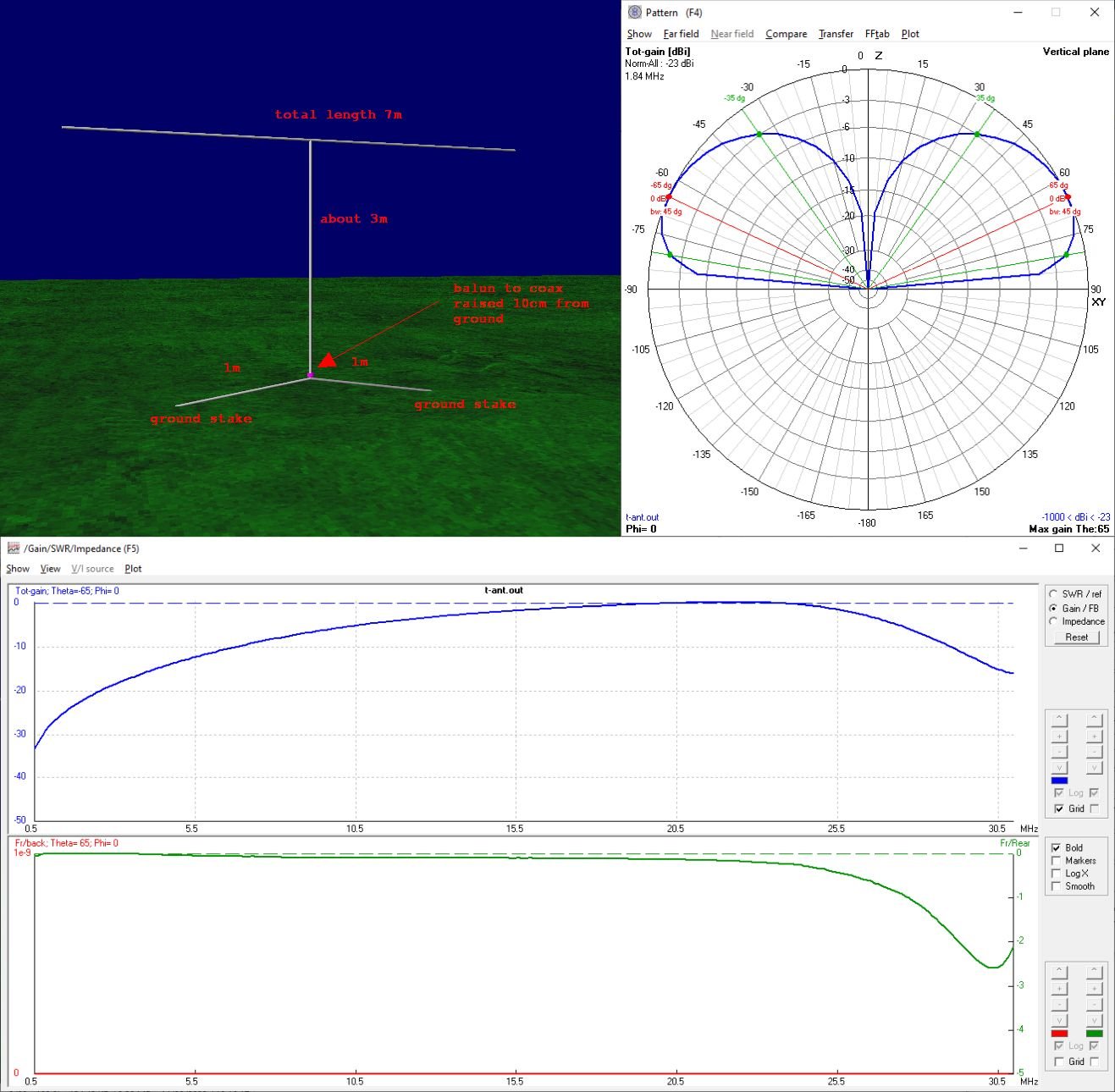

experimentation isn't always a costly thing, "arranging" stuff may bring to cool results :) as for the "radiation angle" that "T" antenna or "Marconi" antenna (it was used by Marconi for the transatlantic contact :D) the graph I already posted here shows it up to 50 MHz
now, the antenna radiation (and reception) pattern is omnidirectional, so imagine it as a "donut" and the graphs shows the donut as if it was vertically sliced in two and observed from a side; the red line shows the highest gain angle, while the green lines show the -3dB ones (still very usable), if you carefully look at the graphs, you'll see that the bottom green lines are low enough (on the horizon, if we think to a real antenna) to allow picking up distant signals, at the same time, the higher green lines are pretty good for mid/short distance reception; that's it, nothing requiring rocket science

here's another idea for you, Jock
the structure is similar to the one we've already seen, but instead of using a short wire connected to a stake at bottom, we use two 1m wires whose ends are connected to a pair of stakes, with the feedpoint raised about 10cm from ground; the result is a bit more gain as shown in the graph, gain which, using a 10...20dB preamp, may be brought up as desired
