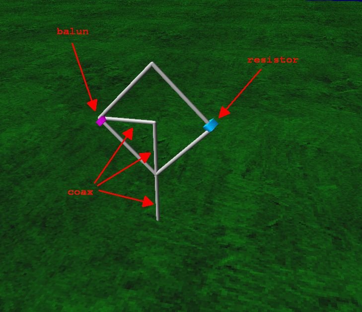

Let me try a "masterpiece of art" :D
the above shows the coax routing, horizontally along the "cross support" arm and then down vertically, judging from currents simulation in NEC, the most effective place for snap-on ferrites should be along the horizontal run of coax
BTW that is the part that causes me the most headaches, having this NooElec Balun sitting horizontally in its junction box at the end of the boom, with the coax putting some pull on the boom and the prospect of chaining another box with the preamp to the balun box. I should have thought of that, there are 90° SMA plumbing pieces available on Amazon. :/
there won't be any "pull" with the config shown above, the coax will just be supported by the same structure supporting the loop; as for the RF preamp, my idea is that placing it at the center of the cross (the point where the horizontal coax turns down) will avoid loading the arm too much

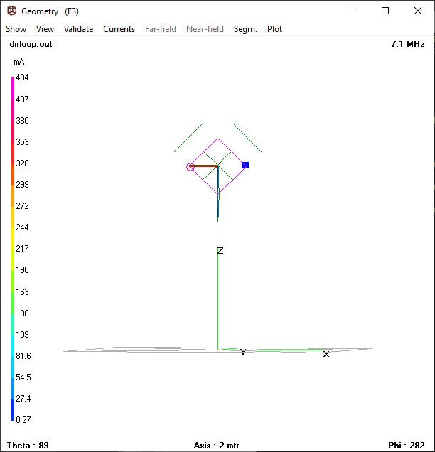

As for currents, here's what the NEC model shows
which shows why I'm thinking that the horizontal segment of coax should be the best suited for the ferrites

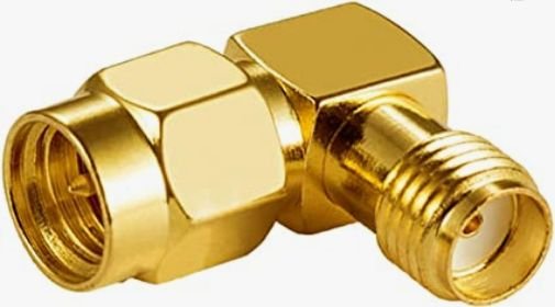

Ah yes, of course - the inside of the loop is probably less prone to be disturbing the pattern and that would indeed solve the problem with the load and the preamp, that could sit just inline with the balun box, at the feed line end equipped with this:

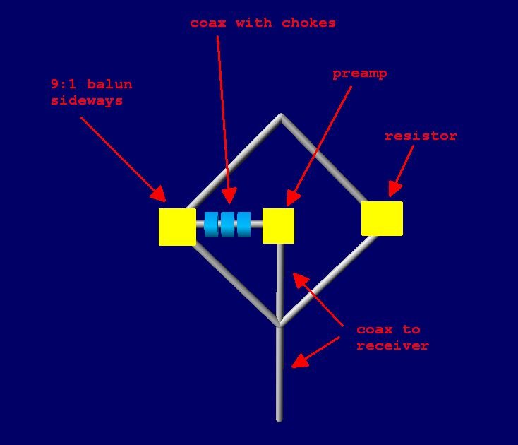

no need for the angular adapter, see this
the 9:1 will be placed sideways in the box, with the connector facing the inside of the loop, from there a run of coax, hosting snap on chokes, goes from the 9:1 to the center box hosting the preamp and, from there the coax exits vertically running along the support pole, down to the receiver, I believe that such an arrangment should give the best balance and won't load the support structure too much (btw, sizes aren't "scaled" in the above drawing)
Yeah I understood this, it's just that I'm usually reluctant to bend coax sharply, even the double foil-shielded stuff, particularly that stiff Belden H-155. Probably unnecessary in this case since that's being bent only once and at the antenna where the integrity of the shield isn't that important. However, the knee adapter would avoid this altogether..

well, the alternative to bending would be using a short "pigtail" between the balun and the preamp (boxes) and then going straight down with the coax to the receiver, then ok, the alternative would be the knee adapter
According to your sketch we basically create a common mode choke out of a coax pigtail and clip-on ferrites. I just checked my drawers and found some cable pieces I obviously ordered for something in the past before I forgot I did, or for what I ordered them but of course they are either 2m long or have the wrong connectors (don't we all know that?). The need of a choke behind the balun is understandable but I was initially planning on / hoping for this:
exactly so, the idea is to avoid adding too much weight to the structure arm supporting the feedpoint by moving the preamp to the center of the "cross" (structure), but if you feel like moving everything (balun, preamp and chokes) along the arm will be ok, then go on that way, all in all you are building it, and in any case, modifications to the structure may be done at a second time, if needed
Wouldn't the choke behind the LNA still be sufficient? That way I could simply clip ferrites to the end of the feedline and let it drop gently down the pole behind that part. Otherwise I do have fitting lengtht SMA window pass-thru pigtails with some super crappy,thin and lossy coax inside (thinner than RG-174), that would do with a gender changer adapter, on the plus side that stuff bends around everything but I'd rather avoid this and have 40cm straight 5mm coax to the LNA (which needs to go on the shopping list first).
Well, to tell the truth, at this point I don't know; probably it will be ok; as for the LNA, if you want for a "maiden fly" you may omit it and then add it later if cranking the RX preamp won't suffice, but if you prefer going for belt and suspenders, then having the LNA won't hurt; as a note, going for my suggested approach, that is balun, pigtail w/chokes, preamp would also allow to quickly bypass the preamp just by disconnecting it from the pigtail and coax and connecting the latter together

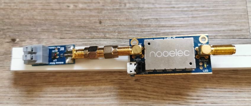

Yeah, another thing I forgot to buy is the alternative to that - a nice pair of M4 bolts and nuts/wing nuts/washers to use cable lugs, making that all as "modular" as it gets. BTW, the balun and the preamp weigh like 20 grams together and I'm planning to omit the preamp first, as long as I don't screw it to the boom I can easily insert the preamp on demand. I'll keep things flexible and zip-tied until I know what works best.
Re balun, the one on the picture is the one I have with the R1 connection cut.
