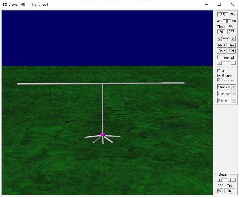

as for the T antenna, an alternate config (if you aren't going to lay down a LoG) may be the one shown in the image below
the leg of the "T" goes down to some inches above ground, there it is connected to the BalUn, the other binding post of the BalUn goes to some radials spread around on ground, the gain of such a system will be around -24dBi at 1MHz with the lowest takeoff angle at 5° from horizon (good for DX), adding a preamp (e.g. the one inside your preselector) will raise the gain enough, such an antenna will have omnidirectional reception with vertical polarization and low takeoff angle and will cover the range going from a few KHz up to around 30MHz, being vertical it won't be so "quiet" but may be worth a try, the alternative as I suggested, may be a Loop on Ground which will serve you well from lower frequencies up to around 20MHz, the pattern and gain of the antenna is shown in this image
