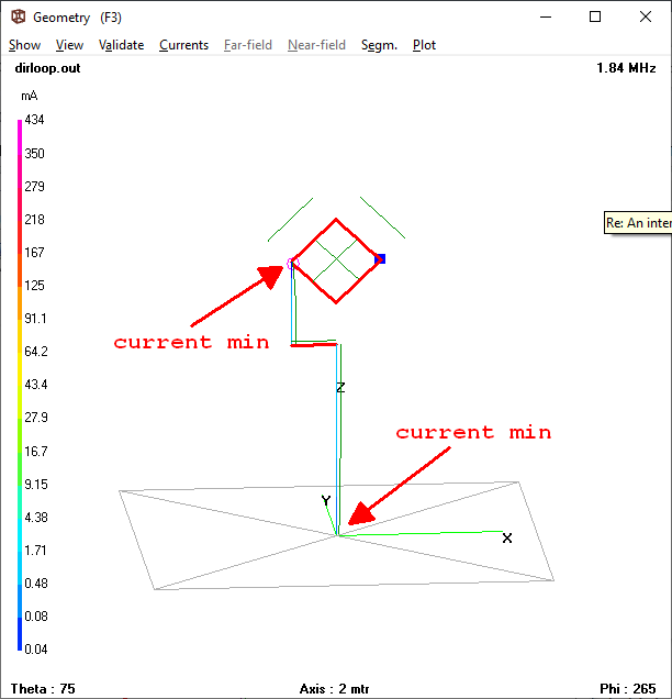

Well, an antenna indoor is subject to reflections and parasite coupling, so I think that the only test would be trying the antenna "in the clear", yet, reading what you reported, the indoor test seems promising; what else... oh yes, I just ran the NEC model of the antenna (the latest one) to check for currents, and currents on the feedline are pretty low, so maybe chokes won't be needed, also, looking at current nodes with the antenna at 3m from ground and the feedline going all the way down, the NEC model shown a node (current minimum) near the base of the vertical support, if that's correct, then placing the chokes there will have higher effect and, at the same time, would solve the "weight" issue, the image below
shows the currents distribution and magnitude, as you can see there are two usable nodes, but the first one is near the feedpoint while the second is near the feedline bottom and more convenient, also looking at the magnitude it's easy to see that the feedline shows a current of around 1.7mA while the antenna loop a current around 220mA, the only segment showing high current is the bit of feedline running horizontally below the antenna, but that shouldn't be a problem given that the real antenna has an "arc" of coax; I may simulate that if needed, but would require putting together a bunch of short segments to simulate the curve <sigh>

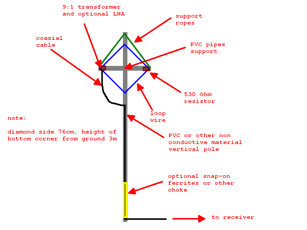

As for support, maybe it's a crazy and too complex idea, but just to play some "brain storming", check the pic below
the idea is to use some PVC pipes to form a cross, the left of the pipes cross hosts a "T" junction which is used to tie the cross to the (non conductive) vertical mast, a rope tied between the top of the cross and the upper section of the mast supports the cross, the coax runs vertically from the feedpoint (where the cross is tied to the mast) so there's no "dangling" coax
Again, probably it's too complex and/or not robust enough, not sure, it's just an idea off the top of my head
As for the idea of adding a switch so that one will be able to include the resistor, exclude it or open the loop at the corner, here are the radiation patterns in the three configurations
now, being able to change the patterns just by flipping a switch would be cool, the problem is that, if we remove the resistor, the impedance at the antenna feedpoint changes a lot, as shown in this image
it's easy to see that w/o the resistor in place, the resistive part of impedance becomes very low while the reactive one raises, this in turn causes losses and may probably cause problems if using the SDL with an external preamp or with a receiver which doesn't "like" too much impedance mismatch (like the Belka), so while running some experiments will be cool, I doubt that there will be real benefit in adding a switch to change the antenna config

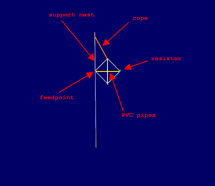

Andrew (grayhat) wrote: Tue Jul 26, 2022 9:29 am As for support, maybe it's a crazy and too complex idea, but just to play some "brain storming", check the pic below
Thanks for the effort, Andrew! But the problem isn't so much the dangling coax (which is ~1m, neither much to dangle nor much weight), it's the weight distribution on a rather flexible fiberglass pole. The antenna has more weight on one side of the horizontal boom of course, which in turn may bend the affordable portable fiberglass poles, which would be a natural companion for this antenna. The smallest of these masts would suffice for the SDL but they're pretty thin and therefore sensitive to this.
I'm currently using the 10m HD mast sold by WIMO and only the lower 4 segments of it, which have some reasonable diameter and that's pretty OK. In fact the additional weight of the ferrite beads was worse than the slightly longer lever and the coax (which had put a weight on the arm anyway). Another problem is the weathervaning effect, which is already something to consider if the antenna is balanced and centered on the pole. I was out at the dike despite rather adverse climate -- it was pretty cold (13°C), wet (showers) and windy (with gusts during the showers) because I was really curious about the changed feedline arrangement and the antenna kept turning southwest and after some gusts it lowered itself to a safe height (some mast segments collapsed) a few times. :)

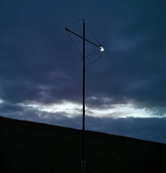

Re the changed feedline...
Fig.1: 5 out of 10 passing cars step on the brake when they spot this. Damn heathens... :mrgreen:
This evening I could observe the directionality for the first time on 20m, previously considered to be the "problem band". I heard a Japanese station and when I was just about to turn the antenna to the north an Italian station called, pretty loud. While I was turning the antenna that station dived considerably into the background and another station calling came up. (That sounds like QSB/AGC action but there was no QSB, it's all me turning the antenna, sorry for the lazy filming of the recorder):
That this antenna seems to love Japan is very likely due to the fact that I can easily turn this straight to the north and cover all northpole and greyline paths between 290° and 70° at once due to the pretty wide beam. The LoG is usually pointing ESE-WNW, with one null pointing more or less towards short path Japan. Next is a pretty much failed attempt at showing the effect on RNZ 15720 kHz. Unfortunately there is too much wind noise, which I didn't hear of course when filming the antenna rotation, but you have to admit the glowing feedpoint illumination is cool: :mrgreen:
A few minutes later the rain started, the wind picked up momentum. Next thing I now is that the antenna was down to 1.5m. The rain stopped just in the right moment for Australia VOLMET. Sorry again for filming the recording (too tired to pry the SD-card out of the Icom and find the adapter to transfer the file, convert it yada yada). First thing you (don't) hear is the station while the antenna is turned off axis, then I FFWD to the point when I have turned the antenna to the north, then after the antenna was raised to 3.5m again:
This is another demonstration that the antenna can still deliver true DX at very little height. I packed up early around 4:00am between showers, conditions were pretty down so I couldn't play with ZL signals on 40 etc. I did pick up some extra difficult TA MW DX tho - first time I tried that in summer and I could pickup Bloomberg Radio from NY on 1130kHz, not good enough to understand entire sentences or ID the station but hey, the lines on the waterfall are back!
Long story short: The antenna seems to work as expected, but only if the expectations are reasonable. :) By this I mean the directionality, its sensitivity has yet to be examined further, that the elevation angle is flat is very much supported by the results so far, more insight will come when I finally get to the dike early enough in the evening to put up two antennas.
13dka wrote: Wed Jul 27, 2022 7:00 am Thanks for the effort, Andrew! But the problem isn't so much the dangling coax (which is ~1m, neither much to dangle nor much weight), it's the weight distribution on a rather flexible fiberglass pole. The antenna has more weight on one side of the horizontal boom of course, which in turn may bend the affordable portable fiberglass poles, which would be a natural companion for this antenna. The smallest of these masts would suffice for the SDL but they're pretty thin and therefore sensitive to this.
Hmm... I see, now here's an idea (no masterpiece of art :D !)
not sure it will solve the fiberglass pole issues, but at least may allow to better distribute the load thanks to the additional supporting rope; I wonder if, by using some PVC pipes inserted over the larger section of the fiberglass pole it may be possible to reduce/solve the issue
but ... but ... :lol:
pretty impressive, and further demonstrates how, changing the antenna orientation it's possible to attenuate or "null out" an undesired transmitting station !
Well, as for the horizontal beam width, I'm fiddling with that in NEC and trying to find a way to make it narrower if possible, the idea at the moment is to experiment changing the size of the loop sides with the latest config and checking the effect, will post an update if I'll find some working "hack"
I won't thank you enough for your efforts in building and testing the antenna ! As for the height, that, along with reduced size was one of the requisites I had in mind when designing this antenna, as you know the idea was/is to find an antenna which could fit even on a terrace or small garden and yet offered decent DX performances, also, one of the "features" of the antenna can be seen by running a 3D rendering of the lobe and looking at the bottom side of the pattern, you'll easily see that it's "cyan", that means that ground waves will be highly attenuated, and that, if the antenna is placed on a terrace, should allow to reduce interferences from the building below the antenna, or at least that's my hope
Well, I don't think "miracle antennas" exist, so... well, this one seems to work decently well (note: Thomas saw that Radio Romania VS BBC video and wrote "That is INSANE! Most impressive!" and also "I look forward to an article that might not only help others built, but also use one" :D) and may help (or at least that's the hope) many SWLers and Hams :)
Thanks again !!!

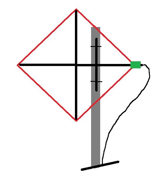

Here's another idea to "balance" the antenna structure, instead of hosting the preamp inside the same box hosting the balun, move it to the point where the coax is tied to the vertical pole, in such a case a "drop cable" will come from the feedpoint to a box hosting the preamp and, from there, the main coax will go down to the receiver, this would allow moving the weight of the preamp to the antenna support pole and possibly have a better balance; also notice where the chokes are placed in my "masterpiece" (previous post), that is near the bottom of the pole, this is because, from NEC simulation, with the bottom of the antenna at 3m from ground, there should be a current minimum at that point, and this will increase the effect of the snap-on ferrites; the only drawback in moving the preamp to the pole is that you won't have that cool "direction indicator" light anymore", oh well :)
Andrew (grayhat) wrote: Wed Jul 27, 2022 7:31 am Hmm... I see, now here's an idea (no masterpiece of art :D !)
What I described earlier is this:
The antenna is mounted to the pole on its center of gravity (like Yagi beams) using another piece of plastic profile. But then again, this prevents folding the booms for transport unless this gets screwed on and off...maybe too much hassle, I like that I just have to unscrew one of the 2 screws joining the 2 booms. The actual weight imbalance with the balun box, the preamp and the coax is maybe 100-200grams since the ferrite beads are not weighing this down anymore and that little weight could be added somehow (what's a good non-metallic weight?) as a counterweight on the other side if need be. I have to order one of these small portable poles to see how that works out practically. For fixed installations this is likely a non-issue anyway.
