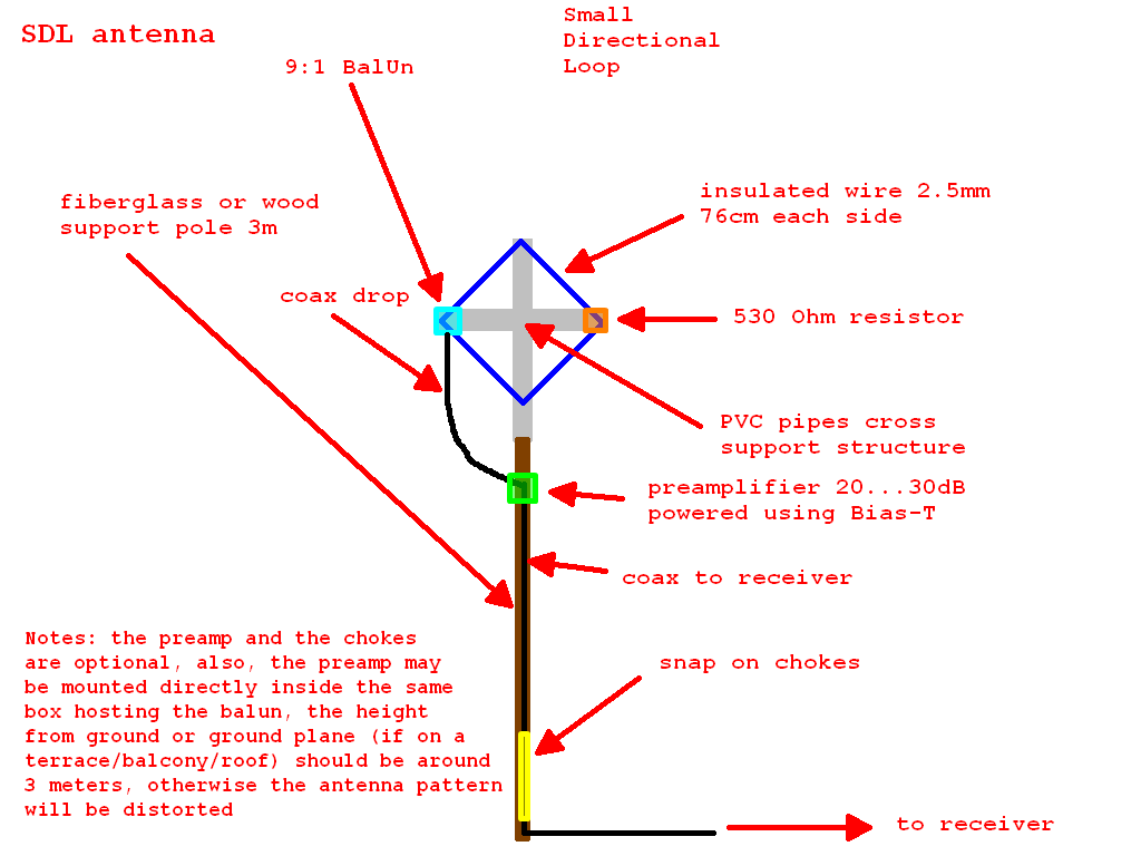

As for the SDL, just to ensure the Chinese folks will copy it correctly, here's a masterpiece :mrgreen: showing the overall setup
as already written, the 9:1 BalUn needs to be a galvanic isolation one with separated primary and secondary winding, willing to buy it, a NooElec 9:1 v2 will fit, the preamp may also be bought and a NooElec LANA HF will fit, otherwise it can be built following the design of the one used for KK5JY's "LoG" antenna; again, the preamp and the chokes are optional, but may be needed for some installations, the preamp can be a NooElec LANA HF barebones or any other decent preamp, the resistor may be a single one or a serial/parallel combination as long as the total value is around 530 Ohm, all the balun, resistor and preamp must be enclosed inside small weatherproof boxes, the loop support structure and pole must be built using non conductive material and the height of the bottom corner of the loop from ground (or floor, if installed on a concrete roof/terrace/balcony) should be about 3 meters, otherwise the loop pattern will be distorted

If I used 75 ohm coax, should I increase the resistor value to around 800?
Hank Michalenka wrote: Thu Jul 28, 2022 2:44 pm If I used 75 ohm coax, should I increase the resistor value to around 800?
Hi there Hank !
No need to raise the resistor so much, leave it as is (530 Ohm), you won't even notice the difference; changing the resistor value may/will alter the antenna pattern, and at any rate the mismatch between 50 and 75 Ohm will be really small; to make an example, consider that the loop at 7 MHz shows an impedance of about 543+j67.5 this impedance is then transformed by the 9:1 to something like 61 Ohm and gives an SWR around 1.26, as you can see, changing the coax impedance won't affect things

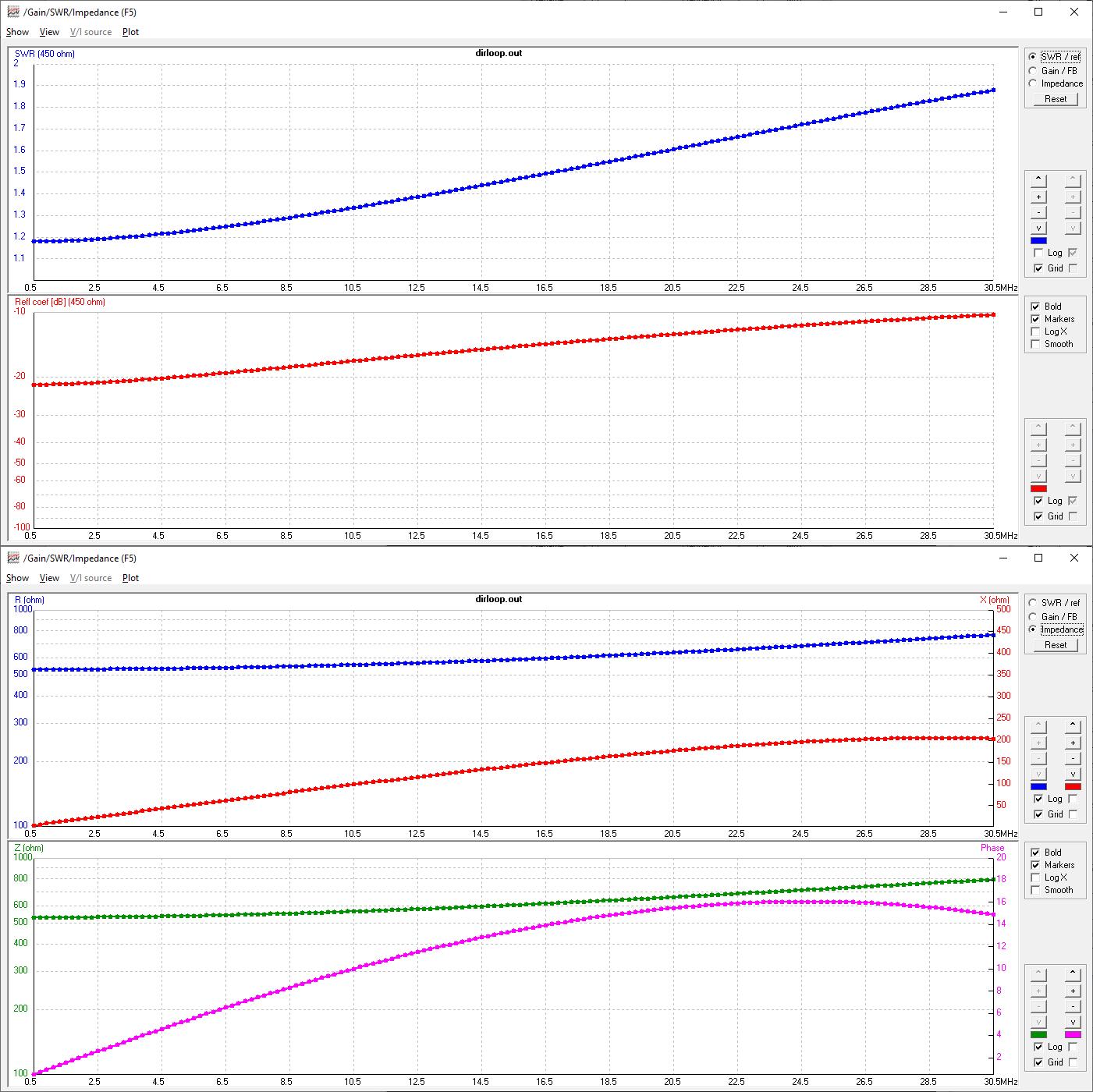

just in case, the antenna feedpoint impedance varies between 531+j4.86 at 0.5MHz and 759+j205 at 30MHz so the impedance value after the 9:1 transformation will fit pretty well for either 50 or 75 Ohm coax
for the sake of precision here are the SDL curves related to SWR and impedance over the 0.5 to 30MHz range

Hank, thank you for your nice words, as for "hiding" the antenna you may tell it's a religious symbol or something to allow birds to rest :)
Just a quick note, while the purpose of this project was to obtain a relatively compact and directional antenna, nothing forbids one to increase the loop size; the chosen size was selected to offer good performance on the whole HF band, but willing to boost the antenna gain, in particular on the lower bands, one could increase the loop dimensions, to make an example, using the "standard" 76cm side loop, gain on 40m is -42dB, if we increase the side to 1m, the gain on 40m raises to -38dB, and the same increase may be observed on the other bands too, at the same time, the pattern is almost identical to the smaller version; the limit for the side size seems to be around 2m, above that, the antenna pattern will start changing, both for vertical angle and backside "null" depth; again, it's just a note in case someone would decide to make the loop larger.
Then if one wants to reduce the size, it can be done too, but gain will drop, for example, with a 50cm side the loop shows a gain of -49dB on 40m and lower going down in frequency, so I believe that the 76cm size for the loop side may be a good compromise between overall antenna dimensions and performances on the various bands; also, as Matt (KK5JY) correctly writes, making the loop larger means that at higher frequencies the loop perimeter will become a not negligible fraction of a wavelength, so its pattern and impedance will largely change, this may not be a problem if one is only interested in lower frequencies, but if instead one wants an antenna covering the MW and SW then it should be taken into account; in my opinion, 76cm is ok for all-round use, having room or using the loop on the field, 1m may give a bit better performance
