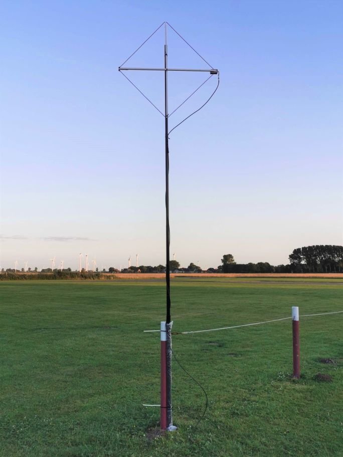

I'm just back home from testing the SDL against the LoG, deliberately at a spot that's a few km off the coast, not free of local QRM but providing enough free space to not disturb the antennas. I aborted the test after the NE short path DX faded out because the main QRM sources are NW of the antennas (so not much fun turn the antenna towards the US) and also it was getting f...ing cold after sunset, not to mention the A index at 10 being a bit discouraging.
I wanted to do this test because what I wrote and marked with *** above - this location is reflecting the reality of listeners a bit more, no perfect ground, QRM sources, ocean too far away to help with gain. If you reckon that this is a disadvantage for the LoG, that's probably both right and wrong - it loses up to 10dB of level there, but so does the SDL, which admittedly has more spare gain than the LoG. That difference was expected and what I wanted to verify. But we know that the (big) LoG is the SNR king and it shows! It was oriented N-S and had the QRM source in its lobe as well and it had a better SNR whenever the SDL was pointing too much towards the QRM. If it wasn't, the SDL unambiguously won though, and had the QRM not been there it would have won in pretty much all situations... because the LoG needs the beach more than the SDL to perform great.
Here's an example with the same Japanese station from the last test: First with the SDL pointing due north like the LoG (the wide horizontal lobe of the SDL should not get much less level if it's not directly pointing towards Japan, but it gets a lot from the QRM from the NW):
This is after turning the SDL to the NE, with the left side of the lobe not covering the QRM source that much - you can tell that immediately by the darker waterfall background:
I'd love to post more here right now but unfortunately the Telekom / T-Mobile has currently a major slowdown+outage problem here and uploading videos takes like an hour each, if it even happens at all. Grrr.
Anyway, with the results from this evening I feel confident enough to say that this antenna delivers what the simulation promises, it's a (very) worthwhile project to build,and - here's the big point - (much) more than a yet another "compromise" antenna, and this is likely a hefty understatement. This is a pretty big achievement, Andrew! Now I wish there would be more people building this now to add their own data points to the discussion!

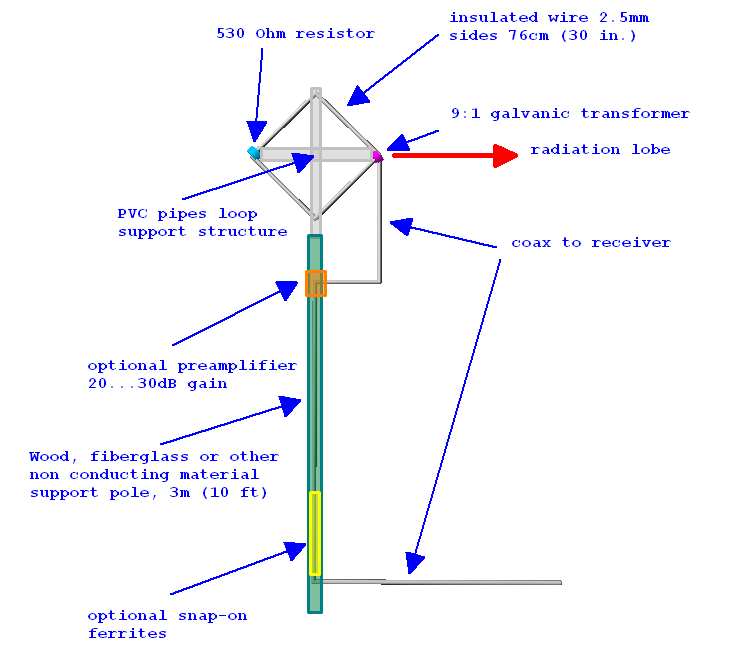

Edit: Here's another picture showing how the drawing below looks in RL:
13dka wrote: Tue Aug 02, 2022 12:50 am Anyway, with the results from this evening I feel confident enough to say that this antenna delivers what the simulation promises, it's a (very) worthwhile project to build,and - here's the big point - (much) more than a yet another "compromise" antenna, and this is likely a hefty understatement. This is a pretty big achievement, Andrew! Now I wish there would be more people building this now to add their own data points to the discussion!
At this point, given the results, I agree with you, the SDL is definitely a good "weapon"; sure, the LoG rules when it comes to cutting off noise, but then it's way bigger and I think that the small SDL defends itself pretty well, plus its reduced size would allow people with small space, or restrictions, to use it :D ! As for more people... <sigh> my wrist is still "out of service" and will probably remain so till next September, otherwise I'd go on, build an SDL and test it here; but there's still hope I think, maybe some other folks here, on the forum, will decide to give the SDL a spin and offer some reports, that would help having a full assessment, although given your results (at home, at "the dike "and at the other "less ideal" place) I'm very confident that the little SDL will deliver good results
For the ones willing to try a build, here's the overall view of the SDL setup
the easiest way to build it will be using off-the-shelf components, for example, the 9:1 can be the NooElec one, while the preamp may either be from NooElec or any other commercial preamp covering the 0.5...30MHz range, the remaining components, with the exception of the snap-on ferrites and coaxial cable, may be found at any local home improvement stores (or the like)
