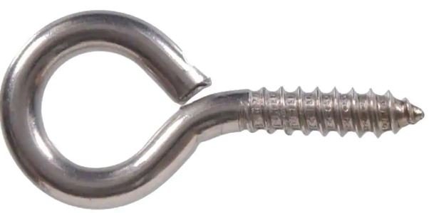

These eye hooks look pretty good for the wire as well..
Eye Hooks.JPG (18.02 KiB) Viewed 189374 times

the box doesn't need to be big, since it will just host the balun and the chock block or (the other box) just the resistor(s), as for the eye hook, it's ok, but don't pass the wire inside the eyelet, suspend the wire using a loop made with nylon cable ties, antennas don't like metallic objects :D

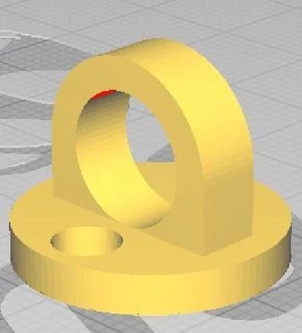

Andrew (grayhat) wrote: Thu Feb 01, 2024 3:30 pm
"... suspend the wire using a loop made with nylon cable ties, antennas don't like metallic objects :D"
Yeah, but I'm trying to be as stealthy as possible. I think I'll go with a few 3D printed eyelets printed in the same color as the building.
