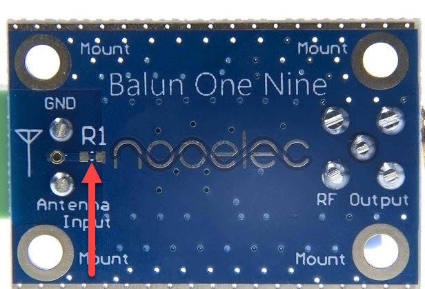

It's the V2 that I have. How is it done for the V2?

Post by rjzastaury »
Do I scrape it here?
