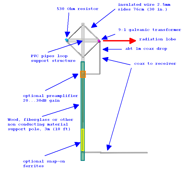

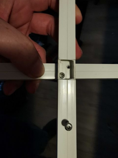

the top part is a cross, formed using PVC pipes or similar material, it serves to support the wire forming the loop, to the left corner of the "diamond" there's a 530 Ohm (approx) resistor, it may be obtained by combining some resistors in series/parallel, to the right corner there's the feedpoint, where the 9:1 BalUn sits, the antenna is fed using some decent 50 Ohm coax (75 Ohm will do as well), the coax vertical drop from the feedpoint, to the point where it reaches the support pole should be about 1 full diagonal, that is about 1m, at the point where the coax joins the pole it's possible to place a preamp (optional but recommended) offering a gain of 20dB or more, from there, the coax drops down along the pole and, at bottom it's possible to place a common mode choke, the latter may be built using some (6 or more) snap-on ferrites closely grouped together and helps minimizing whatever CMC, the support pole must be made of insulating material, be it fiberglass, wood, a bamboo or whatever, as long as it is insulated it will be ok, the lenght of the pole should be enough to keep the bottom corner of the loop at about 3m height from ground or roof/terrace/balcony/porch... floor, in case the pole isn't installed on ground, and in case the surface (floor) isn't a conductive one (e.g. concrete reinforced with steel bars or grid) a piece of metallic "chiken net" may be placed below the antenna to give it a decent ground plane
The 9:1 BalUn may be homebuilt using a binocular toroid core (6 turns + 2 turns on a #43 or #73 binocular core will do) or either the commercial NooElec 9:1 V2 Balun will fit, the same goes for the preamplifier, any preamp working on the desired range (the SULA is effective from MW up to about 500MHz) and offering about 20dB of gain will fit, be it homemade or commercial, a couple cheap commercial preamps may be the NooElec LANA HF or the SV1AFN GALI-84+ but other preamps will work (or you may also build the SULA w/o a preamp although performance on lower frequencies will suffer), the remaining bit, if your receiver doesn't offer Bias-T power over coax or if you don't already have a suitable unit, is a Bias-T power unit, a cheap "chinese" unit like (e.g.) this one may fit, or you may pick any suitable one, as long as the frequency range matches your desired listening range
For the ones willing to experiment and fiddle with modifications (I suggest to start with the antenna "as is" before trying mods), my suggestion is to pick a copy of the free 4NEC2 modeling software and then using it to load the SULA model found below (just save it as "sula.nec")

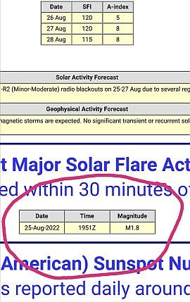

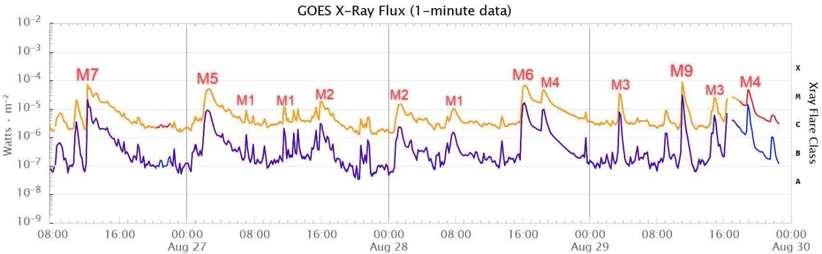

Well, while testing the SULA we had a lot of radio blackouts happening, often taking out the sunlit west when I arrived at the dike in the evening. But without failure, I could hear Japan every evening when I had put up the SULA, and then again next day before noon. When the ionosphere settled a bit, I also heard Alaska more often than ever.

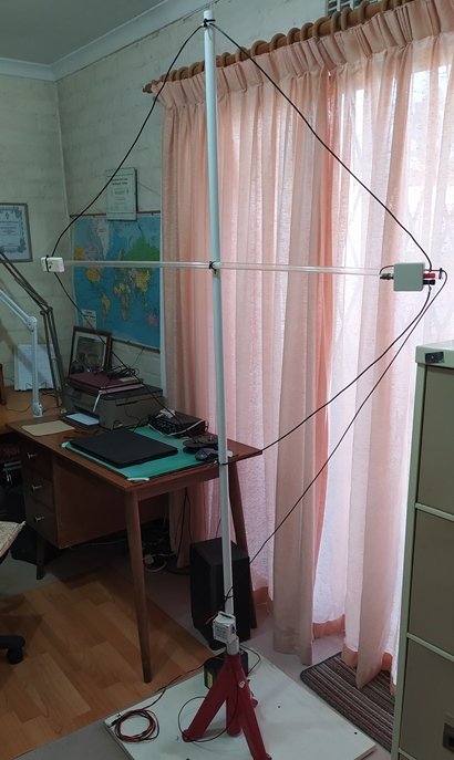

I have just completed my SULA antenna which at the moment is restricted to indoor use due to the WX at the moment but we are at the start of Spring :) I am using 2.5mm stranded copper wire as suggested a commercial 9:1 balun and for the resistor a piece of veroboard (stripboard) in an ADSL filter box with a 470 ohm and 56 ohm resistor in series. The mast and extension to 3 meters is 25mm conduit and the crossbar polycarb tubing 16mm. The wire is attached to the frame using cable ties. The LNA amplifier is from the old version MLA-30. The QTH at the SW tip of Africa is on the slopes of a hill and is a villa and has a good take off over the Atlantic Ocean. So far I have tried SW and MW and both seem to bring in stations on the SULA. I will see if I can get any Transatlantic MW stations from Brazil or USA before sunrise.
Many thanks to Greyhat and 13dka for this innovative antenna looking forward to seeing how it performs compared to my JHG amplified magnetic loop antenna :)

Hi John; nice build and thanks for building and posting, I see one issue, though
The MLA-30 preamp is designed with a pretty high input impedance and to be connected directly to a loop, whereas the SULA, due to the resistor and the 9:1 BalUn presents a 50 Ohm impedance over the whole operating range, this means that the mismatch may and probably will result in less than optimal performance (set aside the other MLA preamp issues), so it would be a good idea considering to replace the preamp with a better unit, that said, using the MLA preamp is still an interesting experiment, please, post back your results !
Oh and... the coax dropping from the feedpoint should be longer and dropping down more or less vertically otherwise being too near the antenna wire it will distort the pattern
regarding the MLA-30 preamp, more infos about its issues can be found here
https://www.g8jnj.net/activeantennas.htm#MLA30
now, if you still want to experiment with that preamp, try this; remove the BalUn and replace it with the MLA-30 preamp directly connected to the loop wire, don't know how it may behave, but will be an interesting experiment, just ensure to let the coax from the preamp drop down smoothly (see the pics posted by 13dka)

Yes, saw those, pity the SULA is just inside (while the doublet is up in free air) and pity the preamp isn't the best one, yet I believe that the results are quite impressive ! I'm waiting for an outdoor test with the SULA aimed toward some station(and opposite to it, just to check the backside attenuation) :D

Hi Andrew thanks for your input.
I will remove the balun and replace it with the preamp as suggested also alter coax feed to vertical drop. I will see if I can find a local sourced LNA that is more suitable as the courier costs to here are high.
The WX seems to be improving so will try the SULA outdoors. 73 John

Hi John, placing the MLA-30 preamp at the feedpoint will be an interesting experiment, but it's untested so I don't know how it will behave; as for LNAs Amazon offers a number of possibly usable ones, regarding the outdoor tests, remember that the optimal height for the SULA is about 3m from ground (or a ground plane if installed on a balcony/terrace/roof/porch - in such a case, a piece of chiken fencing may replace the ground, if needed), the usable height range goes from 1.8m to 4m
as for the preamp and the Bias tee
https://www.amazon.com/Amplifier-50K-2G ... B07NLT9XMV
https://www.amazon.com/10K-2GHZ-Amplifi ... B076Y4N483
https://www.amazon.com/gp/aw/d/B07QGD5FCT
the above are just examples, but may be suitable, notice that since the above LNA doesn't have an embedded bias-t circuit, to use it one will need two external bias tee units, one station side to inject the DC over coax and a second one antenna side to pick up the DC from coax and power the LNA
