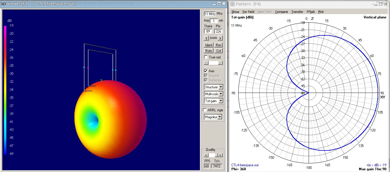

The CTL is a very small antenna unidirectional that fits indoors on a tabletop, as seen on this image:
The CTL apparently achieves its cardioid pattern by combining an interior low-impedance loop antenna with an exterior and coplanar high-impedance loop, with the outer high-Z loop supposedly acting like a "bent whip" antenna that generates a so-called "magnetic shadow" region. It seems to be a rather unique antenna, and its detailed mechanism of operation (involving phase shifts, a variable damping resistor, a magnetic shadow region, and two concentric resonant loops) is intriguingly complex and subtle. A good introductory article can be seen here: https://web.archive.org/web/20201218104 ... planar.pdf .

The above article states that the magnetic shadow operation of the CTL was computationally and experimentally verified on 78-83 of a 162-page report by Dr. Villard, the bibliographic information of which is here: https://ntrl.ntis.gov/NTRL/dashboard/se ... 8180.xhtml
One experimenter who built this antenna reported on it here, but unfortunately without carefully testing its unidirectional properties: https://sv2yc.wordpress.com/2013/04/27/ ... -w6qyt-sk/ .
I was hoping that with all of the knowledgeable and interested people here on the forum, perhaps the above links about the CTL might encourage some discussion and analysis of this interesting and mostly-forgotten antenna. Some years ago, I did a preliminary 4nec2 analysis to confirm the unidirectional pattern. I'm not sure if my analysis is meaningful, but it may serve as a starting point for further analysis.
The 4nec2 file for the antenna simulation is shown below.

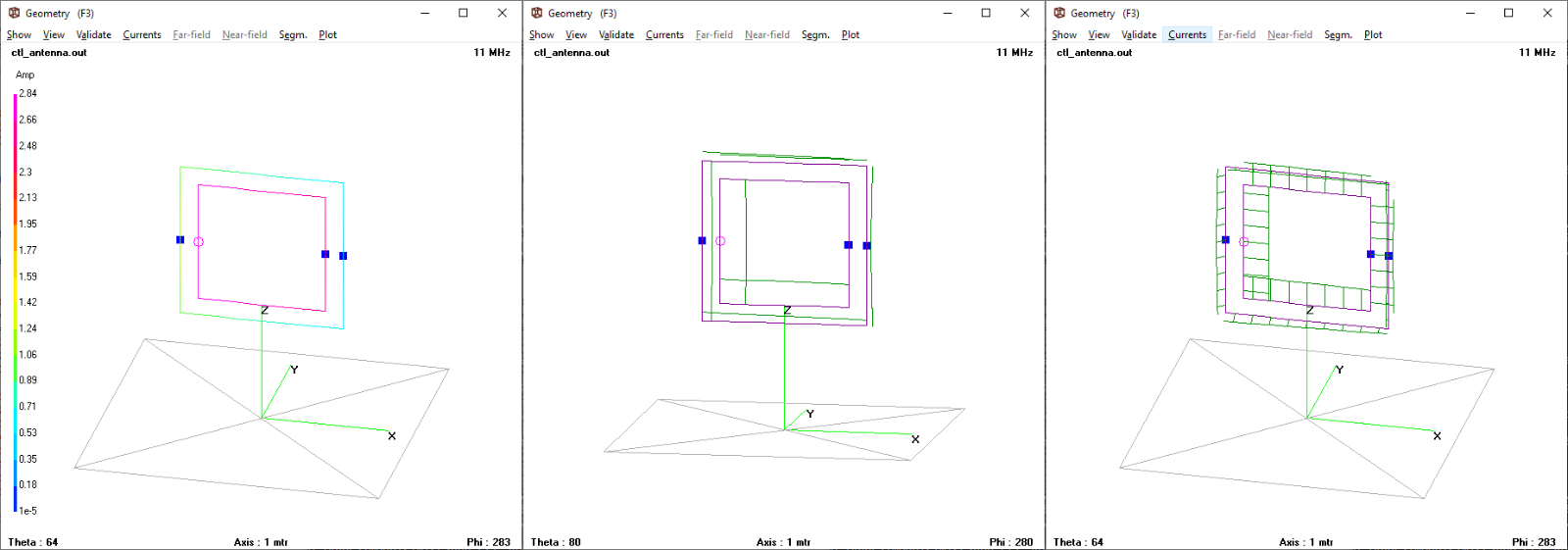

I'm still at a bit of a loss to understand exactly what is happening in the CTL. As I recall from playing around with the simulations, the unidirectional aspect of the CTL is achieved solely by the outer loop; eliminating the inner loop entirely from the model still allows the same unidirectional pattern to be formed.
So I guess the signal could theoretically be extracted from the outer loop. But the CTL doesn't do that. I wonder why. Instead, the CTL uses the combination of two coplanar resonant loops and a "magnetic shadow" region caused by the outer loop to achieve the unidirectional response of the signal that is finally extracted from the inner loop.
I did an excitation test in 4nec2 where I had a small vertical dipole emitting an 11 MHz signal, and I observed the induced magnetic near field of the exterior loop (in this simulation, I omitted the interior loop). There was indeed a "shadow" effect -- when the transmitting dipole was located on the null side of the exterior loop, there was a very low magnetic field excited in the interior region of the exterior loop, but when the transmitting dipole was relocated to the non-null side of the exterior loop, there was a high magnetic field excited in the interior region of the exterior loop.
Then, I guess we could say that the interior loop is just a normal small resonant loop antenna that feeds the receiver. In its extreme near field zone, it responds to the magnetic field, not the electric field. But the outer loop blocks or shadows all incoming magnetic-field energy that comes in from one direction only. Conceptually, it makes sense, and somewhere I even have the 4nec2 files showing the shadow region, but it's still a bit of a mystery for me to really understand, from first principles, how the exterior loop is able to generate this shadow region.
So, to summarize my rambling: can we perhaps say that the SULA uses the same principles as the CTL -- resistive loading of a loop antenna -- to achieve a unidirectional response? The difference is that the SULA extracts the signal directly from the antenna, whereas Villard (creator of the CTL) recognized the interesting fact that the unidirectional loop antenna also creates a unidirectional magnetic shadow region, and thus the CTL extracts the signal by using another resonant loop from within the shadow region.

as for the directional lobe, check out the currents and phase of the CTL, that should tell us something, I believe

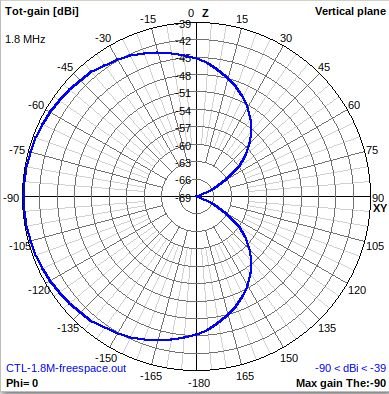

It's not necessary to change the loop size. You simply need to increase the loading of the outer loop by increasing the lumped inductors, and increase the loading of the inner loop by adding additional turns in series with the inner loop. Because it is difficult to simulate additional turns in 4nec2 (very small parallel loops cause numerical inaccuracies), you can also use (in 4nec2) lumped inductive loads to increase the inductance of the inner loop.
The outer loop should be resonant at the desired frequency with a low capacitance of maybe 10 pF (meaning the loop is high-impedance); the inner loop should be resonant at the desired frequency with a high capacitance of maybe 300 pF (meaning the loop is low-impedance).
Have a look at the updated 4nec2 file. The outer loop is the same size as before, but now has an additional 400 uH of lumped inductance in series with the inductor. In the simulation the inductor is lossless. In reality you would probably need to use a ferrite core to achieve the required inductance with low loss. The inner loop is also the same size as before, but has an additional 25 uH of lumped inductance. Again, in a real build it is recommended to increase the inductance of the inner loop not by using a lumped inductance, but instead by using additional turns.
Also note that in the simulation, the wires are lossless conductors, so the gain figures are unrealistically high. Add some wire resistance to get more realistic gain figures.
Finally, due to the lower frequency, the segment size is too small, which causes a 4nec2 warning, but the results still seem plausible.

CM
CM 1. Estimate the loading inductance required to resonate the outer loop at frequency f with C2 at 10 pF. This ensures the outer loop is high-impedance. Add this load to the outer loop, opposite of the capacitor.
CM
CM 2. Estimate the loading inductance required to resonate the inner loop at frequency f with C1 at 300 pF. This ensures the inner loop is low-impedance. Add this load to the inner loop, opposite of the capacitor.
CM
CM 3. Detune C1. Place the feedpoint on the outer loop, opposite of C2. Optimize C2 for resonance such that X=0. If this is not possible, then the loading inductance for the outer loop is wrong and needs to be adjusted.
CM
CM 4. Detune C2. Place the feedpoint on the inner loop, opposite of C1. Optimize C1 for resonance such that X=0. If this is not possible, then the loading inductance for the inner loop is wrong and needs to be adjusted.
CM
CM 5. Set C2 back to its resonant value. Optimize C2 for best F/B ratio.
CM
CM 6. Optimize loading resistance RL for best F/B ratio.
CM
CM When properly adjusted, the model shows a unidirectional null, both in free space, and above ground.
CM
CM Note that the outer loop must be high impedance (achieved by a loading inductance), and the inner loop must be low impdeance.
CM
CM The model has initially been adjusted for a unidirectional null at 1.8 MHz in free space.
SY h=1.0
SY r=6.508e-4
SY c1=2.51e-10
SY c2pf=8.441943
SY c2=c2pf*1e-12
SY rl=205.253
GW	1	7	-0.5	0	h	0.5	0	h	r	'Wire 1, 9 segments, halve wavelength long.
GW	2	7	0.5	0	h	0.5	0	h+1	r
GW	3	7	0.5	0	h+1	-0.5	0	h+1	r
GW	4	7	-0.5	0	h+1	-0.5	0	h	r
GW	10	9	-0.642857	0	h-0.142857	0.642857	0	h-0.142857	r
GW	11	9	0.642857	0	h-0.142857	0.642857	0	h+1.142857	r
GW	12	9	0.642857	0	h+1.142857	-0.642857	0	h+1.142857	r
GW	13	9	-0.642857	0	h+1.142857	-0.642857	0	h-0.142857	r
GE	0
LD	0	2	4	4	0	0	c1
LD	0	11	5	5	0	0	c2
LD	0	13	5	5	rl	400e-6	0
LD	5	0	0	0	9.9E+99
LD	0	4	4	4	0	25e-6	0
GN	-1
EX	6	4	4	0	1	0	0	'Voltage source (1+j0) at wire 1 segment 5.
FR	0	0	0	0	1.8	0
Re: Another unidirectional small loop: the Coplanar Twin Loop
Thank you, ran the model and it behaves as expected, I just changed the "GN" card to put the antenna over real ground and not in free space ("GN 2 0 0 0 13 0.005") the results are pretty good, but the impedance is around 2 Ohm which means that, to couple the antenna to a receiver we'll need to use a preamp/buffer designed to accept such low impedance and offering an output impedance around 50 (or 75) Ohms, and this adds another degree on complexity, not that it's bad, but sincerely I prefer simpler stuff :) in the "SULA" case, the same resistor which gives the cardioid pattern also serves to give a wideband impedance around 450 Ohms, which just using a 9:1 can be easily matched to a coax feeder or to a standard LNA; a thing which would be interesting to test, either with the SULA or with the CTL is a tuned stage like the one described here
http://www.arrl.org/files/file/QEX_Next ... Steber.pdf
such a unit would allow to "tune in" the desired frequency and coupled with the unidirectional characteristics of the loops should greatly improve them

which could be easily modified (e.g. adding a second, smaller size loop inside); what else... oh, yes, please give a spin to this modification to your CTL model

i added a couple wires (tags 14 and 15) and two symbols, I think you'll understand what they're for; give it a try and tell me what you think :) !
